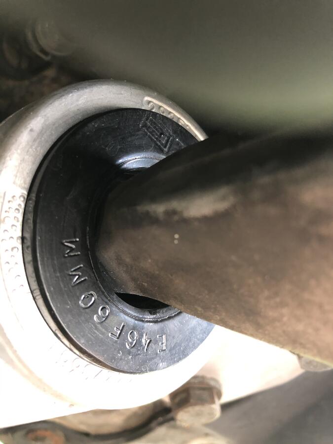

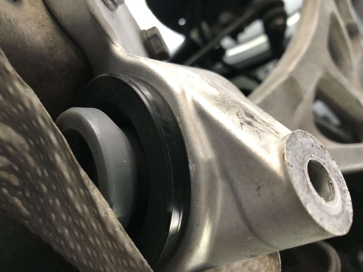

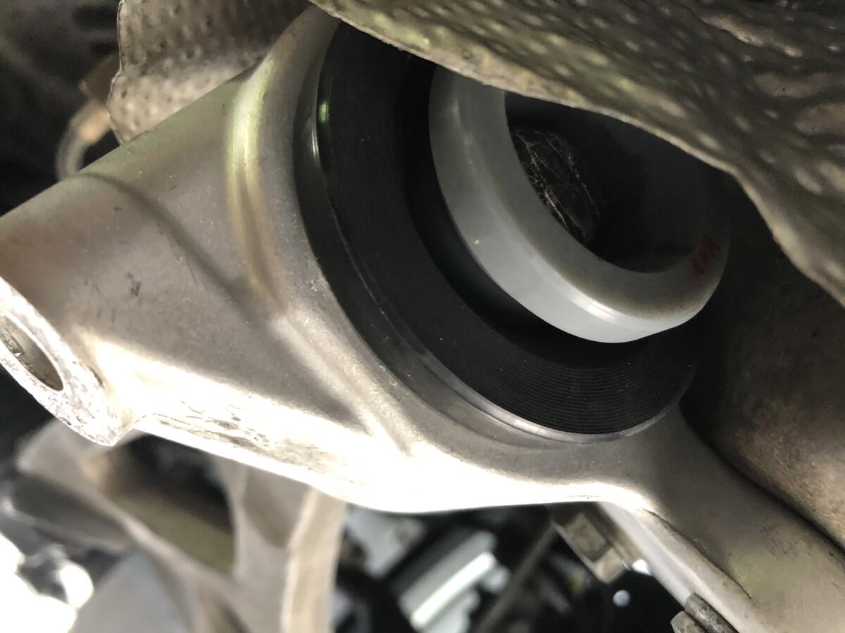

While driving, if I tap my brakes, my steering wheel would jerk after each tap. That’s never happened until now.. Not sure what it is. Pads & rotors are fairly new. Car gets driven once or twice a week. FCAB (AGK Poly) have only been on a month or so (improperly installed?). Anyone ever have this problem before or know what’s causing this?
Steering wheel jerk while applying brake
I would check the FCAB and if it flexing too much under braking then it could cause the symptom you have. The other reason is somehow one of the front brake grabbing brake rotor too much but I don't see why suddenly this happens as it was not touched on recently.Originally posted by Mattn1192 View PostFCAB (AGK Poly) have only been on a month or so (improperly installed?).
Good opportunity to put non-poly's in. You may consider monoballs such as Turner's - I'm biased and have them but if you search you can understand other preferences. To get back on track quickly, and if DIY, consider the option already pressed into housings.

OE rubber is compliant, quiet but will wear out.
Solid/spherical needs maintenance, not compliant, but will last a long time if maintained.
Poly is compliant, noisy, and will wear out…if the passenger side doesn’t burn up and disintegrate.

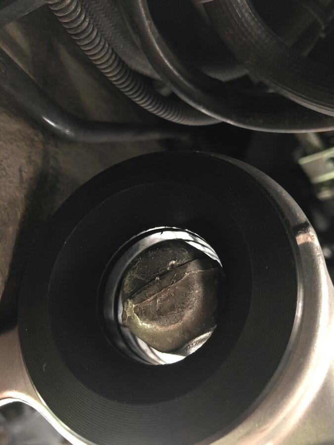

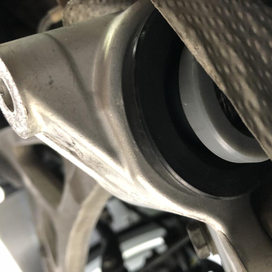

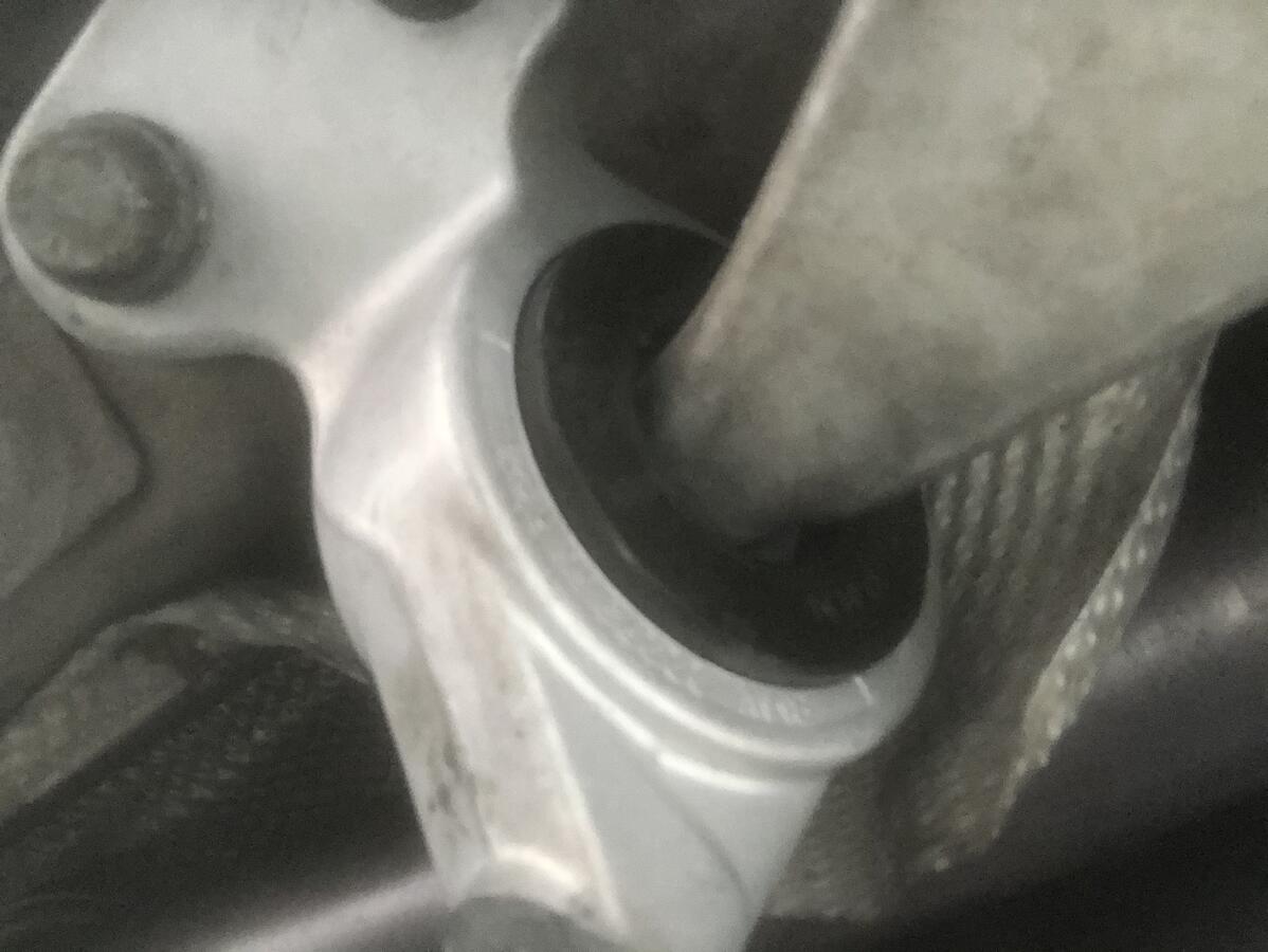

It’s installed backwards. The insert is flanged and should face the front of the car or the control arm. The flange prevents the insert from being pushed through the outer bushing.
The flange is on the back so the insert is being pushed through the bushing and will likely come off the control at some point. Handling will be very interesting at that point.

lol! You can imagine what the faithful rear axle is going through as it tries to follow what the dodgy front is up to under the brakes.Originally posted by bigjae46 View PostIt’s installed backwards. The insert is flanged and should face the front of the car or the control arm. The flange prevents the under from being pushed through the outer bushing.
