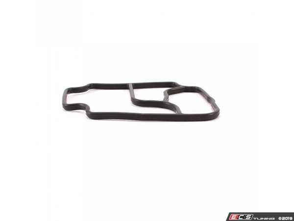

      I wonder if the M3 has better gasket material than the non M cars. The housing to the block is very similar so why M3 has no issue on this.
      I think it has to do with the M54 block being aluminum and the S54 being Iron.
      The gasket is the same part number IIRC.
        Same material-- it's the same part, in fact.
