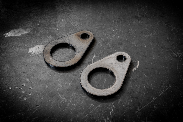

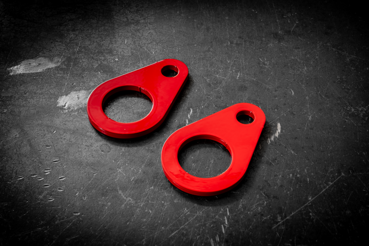

    AKG motorsport has towing eyes you bolt to your rear lower damper mount for 20$. Quick, easy, lightweight, no cons that i know of.
    Our BMW E30, E36, E46, Z3, Z4 rear tie down eye hooks install on the rear shocks to provide attachment points for secure tie downs. Made in USA.
      +1 to using the wheels. Be careful use proper gear and take your time, you wont scratch anything or cause issues. Yes attaching to the suspension can cause damage. Attaching to the frame imo isn't a good idle considering how light and pretty weak our frames are to cracking
        https://www.akgmotorsport.com/produc...n-rear-shocks/
        These work well, but don't cross the straps in an X pattern as it will likely bend the towing eyes. Go straight back from the towing eye to your trailer attachment point with the straps.

              Garagistic also does some tie downs like the AKG Motorsport ones linked earlier:
              REAR TIE DOWN ADAPTERS FOR YOUR E30-E46! If you tow your car to the track , you need a good way to hold down your E30, E36 or E46 BMW. The lower control arms under the 3 series are not ideal. You may have nice wheels on your car and in the case of an emergency, the tow guys might run a strap right on the lip of your ri
              I installed a set of these so they were an available tie-down option at the Dyno in case required... When I explained the power output range of my car the dyno operator laughed and used wheel chocks instead, saying I'd need to more than double my desired power output before tie down would be an issue haha, I have left them on ever since just in case as they seem more handy to have then to not.
