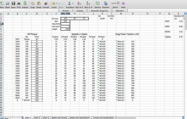

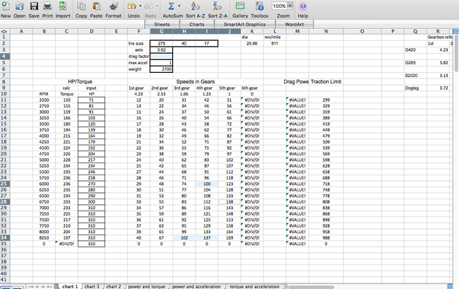

Gearing: I know exactly what are you asking from the engine at the track when you
want say need the rev higher so that you will hold on one gear and avoid shifting.
Note, the charts I made for you and take this numbers and compare it to your telemetry
track info.
By rising the rev limiter as you aim so that you don't shift you are going to gain very
little...1mph here 1mph there....
If I were you I would put 4.27 ring and pinion. Why ? sounds absurd but in real world
your car will be faster because the 4 and 5th gap is very nice and close. 3rd gear will
be used in low speed corners which is great because it will act like tall 1st gear as on
all race gear boxes and ones you accelerate 4th gear rpm drop will be small and then
on 5th gear the rpm drop will be right closer to Pick-HP and then at the end of the straight
you will reach your top speed right bro the rev limiter.
Hi speed like 100mph-120mhp+ one needs power to fight the air drag. Look at Dodge Viper
ACR at the curb weight as the E46M3 std can't reach 300km/h-180mph due to its massive
aero, an engine that is almost 2.5 times the size of an S54 and massive 650hp or so.
Our BMW engines are hi revving and one need relatively short gearing and very little rpm
drop so that to fight the drag.
Don't forget in race gear box all the gears are used at the track. Not sure if you have driven
Laguna Seca but the GTRs were filling up 5th gear at this given short straight....
So in your case you will same as now 3rd 4th and 5th I assume is why you are asking to rev higher
so that you don't up-shift to stay on 4th gear ? or you upshift in 5th before. I assume your engine is
tuned and your power has been shifted to the right aka up top.
With 4.27 even at low speed off a corner you will be right "In-Cam" 4500-5000rpm so your window
range will be all out usable and the S54 will be always in easy to pull hard on the revs.
Take look the charts and lets look at it together, share more info from the track telemetry.
such as what is the slowest corner at Cota let say.
Note in Blue the RPM drop between gears. 4.27 is "Win-Win"
track info.
Regards,
Anri
3,62
3.91
4.27
