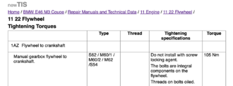

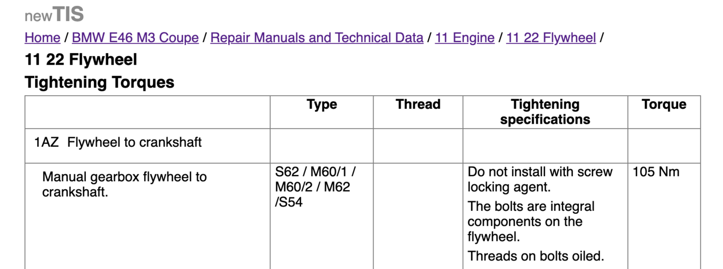

    The yellow stuff might not be threadlocker, but a yellow threadlocker does exist. Usually, the common threadlockers are blue and red. TIS states the same thing about the bolts:
    Click image for larger version  Name:	Screen Shot 2021-08-23 at 11.49.16 AM.png Views:	0 Size:	166.6 KB ID:	122599
      Interesting, hard to argue with TIS here. I wonder exactly what the yellow substance that comes on the bolts is, given the standard threadlocker on all the BMW bolts I've seen is blue.
      In that case, oiled and torqued to spec looks like the recommended route. Hopefully it's G2G with the correct torque spec in a star pattern, but one can't help but worry.

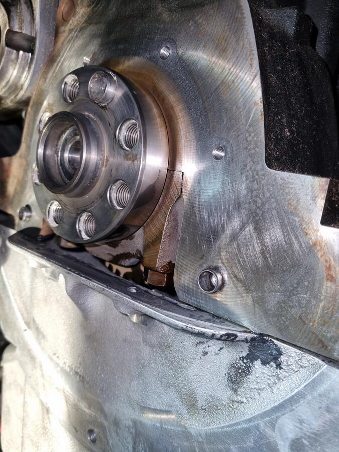

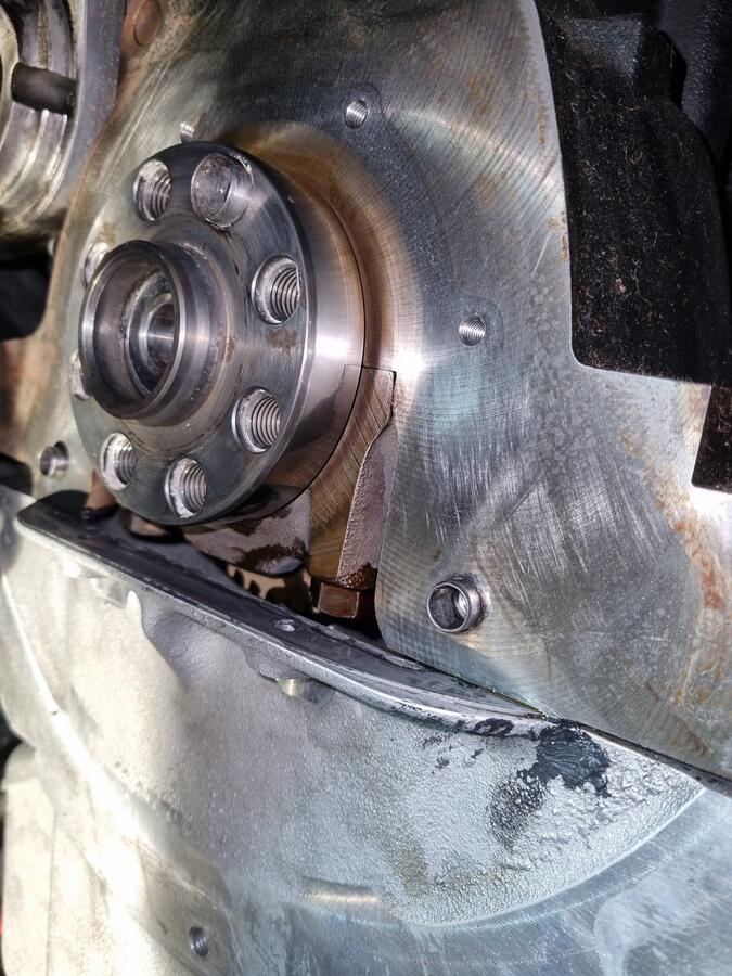

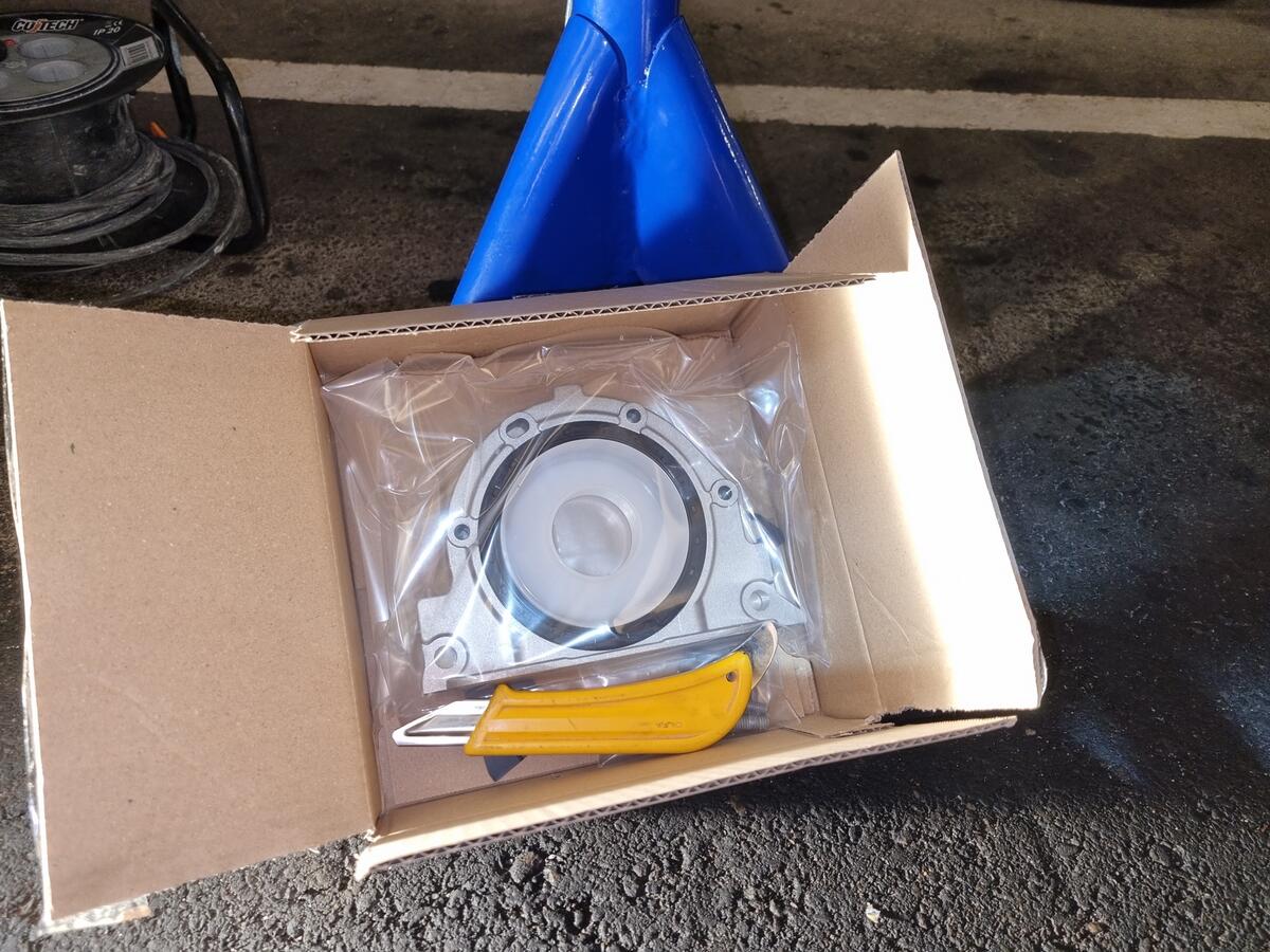

                Following curiously as I'm having my gearbox out for the 2nd time this summer after I developed a leak from the RMS area when I did a SMG -> manual conversion with new LWFW + clutch and new RMS. After I disassembled it the 2nd time around, due to my engine oil being fairly fresh, I couldn't see a clear culprit, but will definitely look into using thread sealer on the FW bolts as well as the RMS housing bolts.

                        Jackstands indeed๐Ÿ™ˆ Kinda sucks but I got myself a 2nd low profile (but higher lifting) jack so at least the jacking part of the job isn't such a time consuming event anymore. And I got it 1 notch higher on the stands so I can now (just about) sit upright in the trans-tunnel which makes doing this job ever so slightly less cumbersome. Last time I sort of had to do the ultimate core strength workout whilst adopting a banana shape on my body sitting on my ass.. It was a real workout!

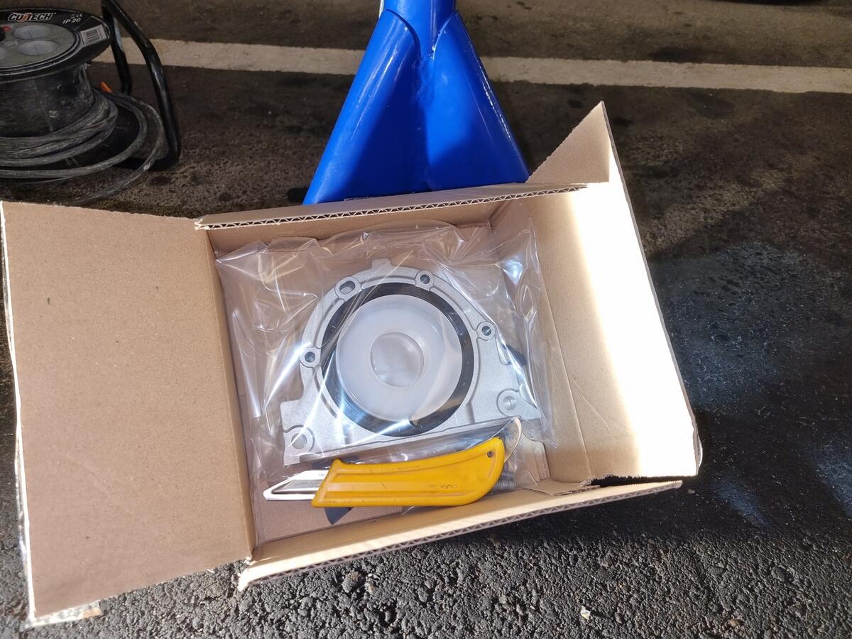

                        Yeah did all the RTV stuff. The worst part about this job was that when I got the FW off I couldn't see a clear culprit to where the leak came from. But I've ordered the RMS pre-installed in the housing this time. Will chase the threads in the block and crank with a tap to get the old gunk out, drained the oil pan and will use thread sealant on the bolts as well as RTV to hopefully get this right the 2nd time around. Also been advised to run 3000 grit sandpaper wet/gently around the hub and lube it up before installing the RMS and housing and I think the pre-installed RMS will also come with a storage collar around the inside lip which also doubles as an installation tool.
                        Fingers crossed I won't have to do this again.
                        Regards

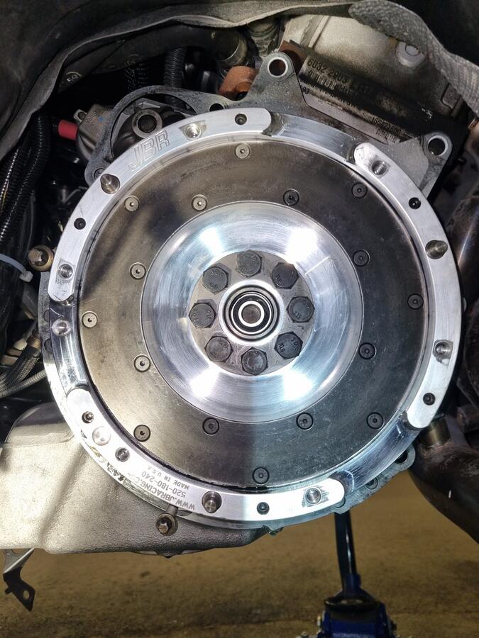

                            I ended up polishing the crank before using the plastic storage item as a tool to fit the RMS. Also bought thread sealant and applied this to every bolt used for the housing, flywheel and pressure plate. I don't see the harm in this, and torqued things to spec.
