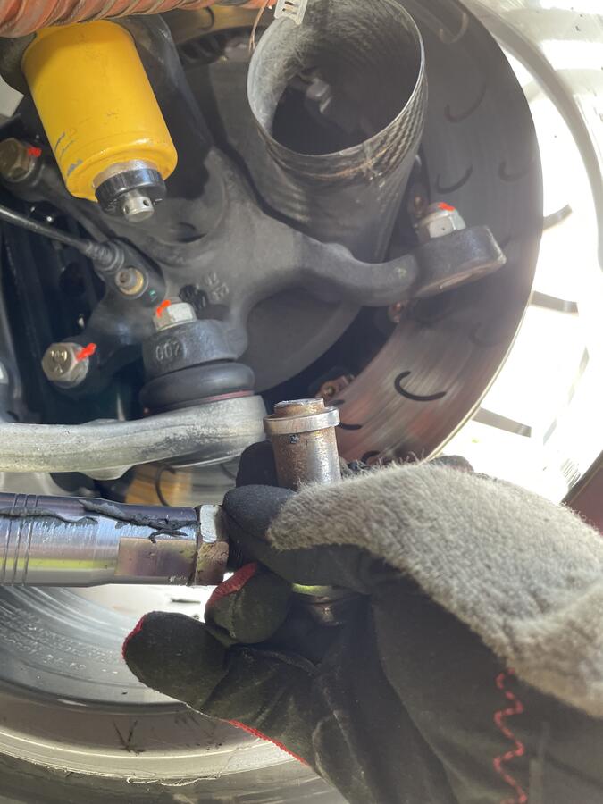

    to anyone running the VAC tie rods. This failure was at the glen. Just a reminder to inspect critical components. No evidence to suggest that there is anything wrong with the VAC product, but that failure could have ended much worse!

        I agree with the importance of tech, but I'm curious if there was even any visible indicator of this before it failed.
          So if it wasn't the fault of the tie rod then what was the reason for the fault?
            I'm not inferring there was - but Tech is there to find things early - that can be found. I've seen a suspension failure at a PCA HPDE that ended involving more than one car and bent metal. Not to mention the safety aspect.

                  It looks like it's Crooked Commie. I think he is on this forum, he was definitely on the old one.
                    What's odd in the photo is the sheared taper (remaining in the spindle) is flush to the spindle. The stud attached to the tie-rod still has part of the taper on it, suggesting that the flange on the stud wasn't sitting flush to the spindle.
                      my thoughts as well. It would appear that the tapered stud was not machined to the proper max OD.
                        VAC par.
                          All - this was my car, running the VAC Bump Steer tie rod kit. Yes the car is inspected and teched before every event. There was no indication on the stud of an upcoming failure. The tie rod spherical was functioning as expected with no play. Installation was absolutely completed to spec. I will have to review how many events exactly were on this tie rod. Below a picture of how it sheared. I think there is a moment arm being created that will eventually fatigue the stud where it meets the spindle. I am switching to stock tie rods for now, and looking into the SLR or AKG kit for the future - I'm not comfortable running the VAC bump steer or their control arms anymore.
                            This is how their stud is designed, and yes, I believe this led to the failure. The stud should have a shoulder to sit on the spindle or it will eventually shear in this manner. Hence why I am looking into the SLR kit as it has a whole bracket that seats on the spindle.
