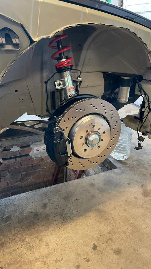

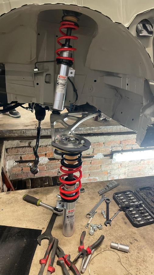

      I have similar requirements and opted for Eibach Pro-Street Coilvers, GroundControl Street Camber Plates, + OEM CSL/CS Calipers & Disks. It is important to note I have NOT driven this setup yet as my car is still being built but hope to have it back soon.
      I chose Eibach Coilovers over the others only because it was a simpler design with no dampening adjustments, which is also a con to many if not all people but for me, I don't mind. The GroundContol camber plates are different than typical camber plates because they include dampening AND have the caster and correct M3 angle. I opted for CSL/CS brakes because I wanted to keep the unsprung weight low because I'm running heavy 19" BMW 163M wheels and don't think because of my 99% street use I will need the additional stopping power of BBKs.
      There's not much out there on these Eibach but here are a few references:
      User Review (e46Fanatics) 1
      User Review (m3Cutters) 2
      Eibach Pro-Street Coilovers (NOTE: There's a Euro version that is different and is supposedly rebranded KW1)
      Click image for larger version Name:	896A21AC-AAB9-44F0-99B1-720EC6D0796B.jpg Views:	23 Size:	81.3 KB ID:	200631 Click image for larger version Name:	799BEAF3-CEE9-41CB-BD28-5DBE93BEB94D.jpg Views:	23 Size:	75.6 KB ID:	200632
      Not to be the bearer of bad news, but my M3 wagon came with the Eibach coilovers... and they were terrible.
