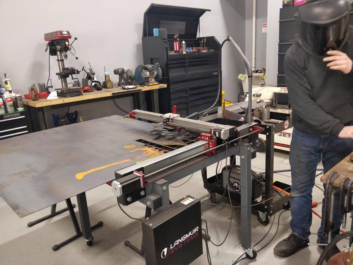

            Cutting the pieces out of 1/8" plate on plasma CNC at MT Fabrications.

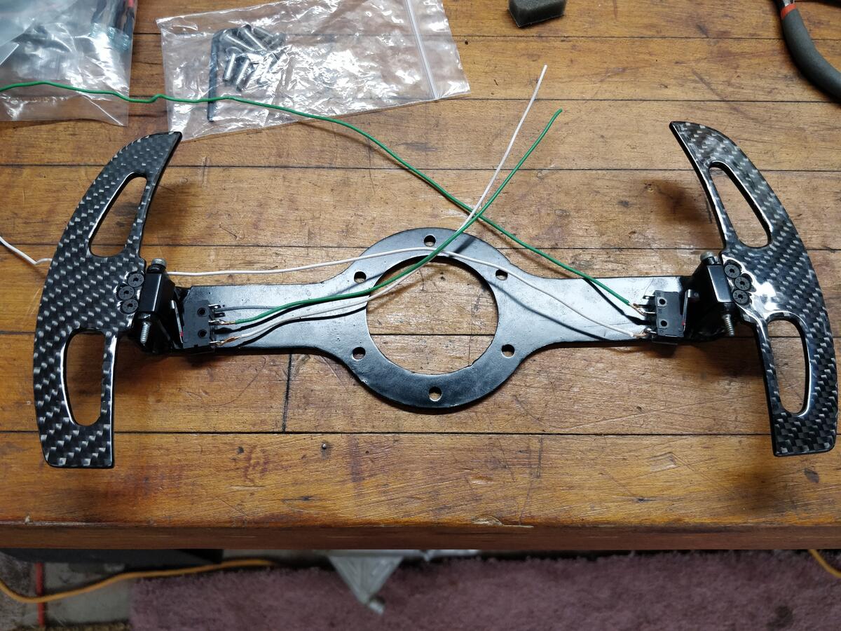

            I welded the pieces, shot a coat of black on it and started wiring the microswitches.

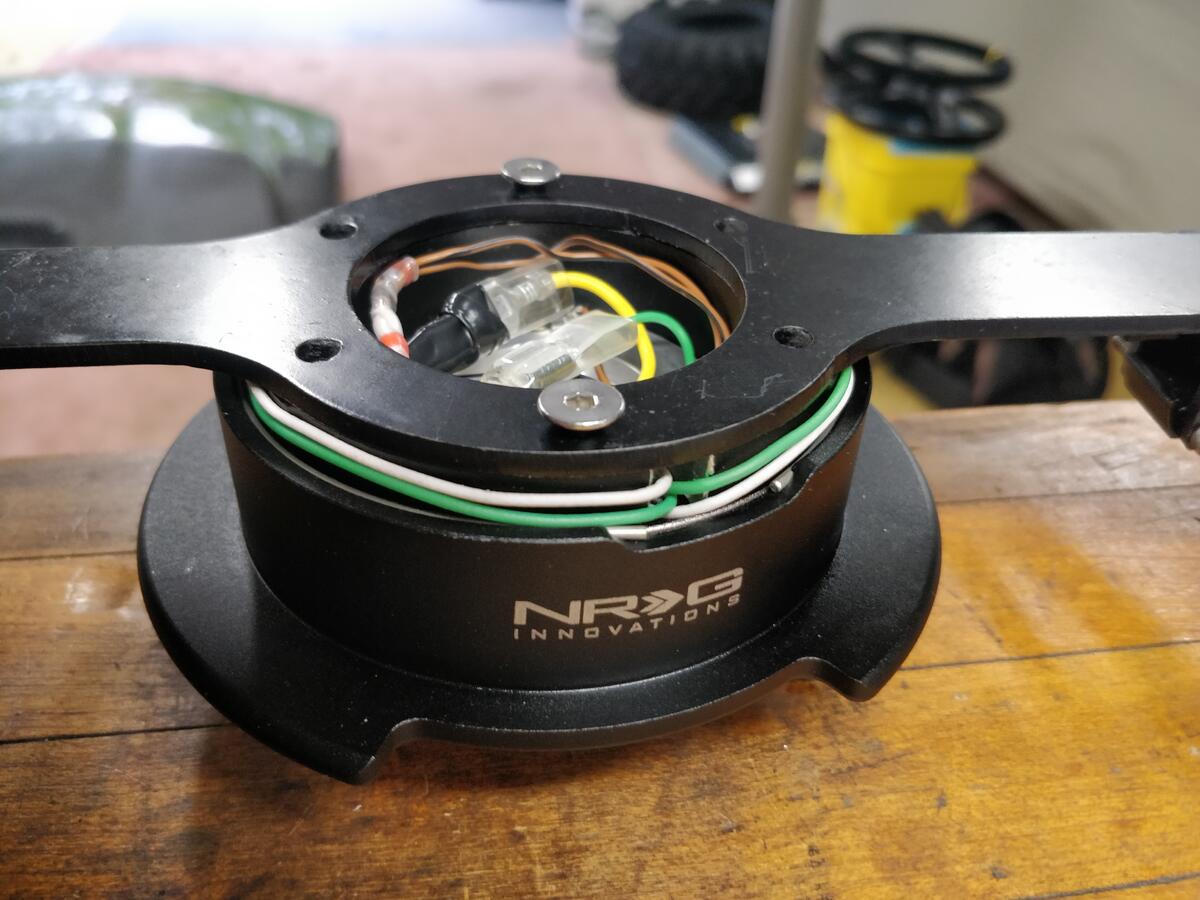

            I used solid copper line so I could bend the wires and have them hold a shape. I enlarged and slotted the pre-existing hole in the quick release hub so I could feed the wires. No sharp edges were left as I chamfered them all.

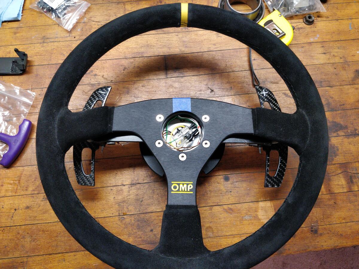

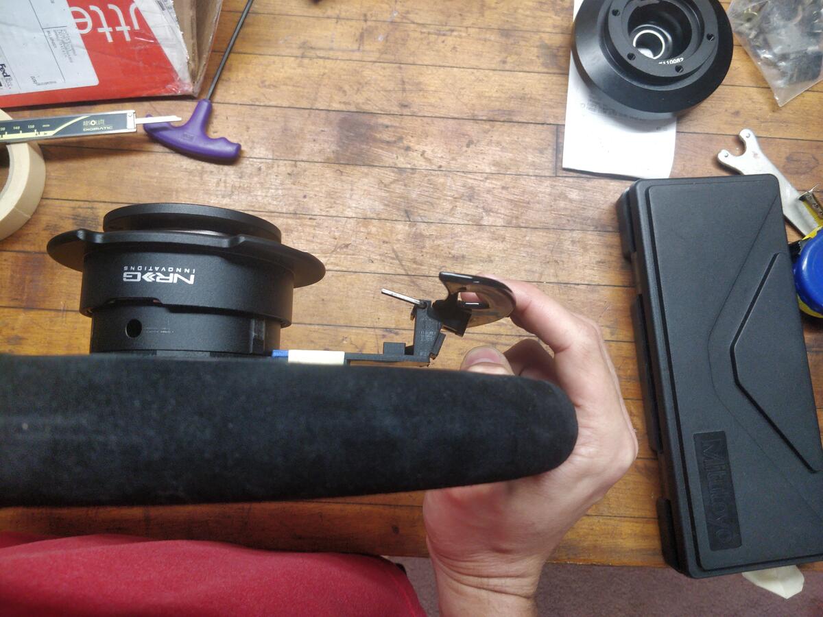

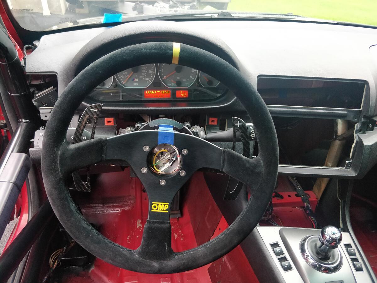

            For a first shot at this design, I'm pretty happy with how it came out. I have a few small tweaks in mind for when I eventually redo it, but I took this for a test drive and it worked exceptionally well so I'll probably run with it as-is for a while.
            Click image for larger version Name:	IMG_20200522_170055.jpg Views:	0 Size:	194.4 KB ID:	32183
            Click image for larger version Name:	IMG_20200605_193501.jpg Views:	0 Size:	143.1 KB ID:	32184
