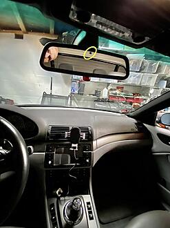

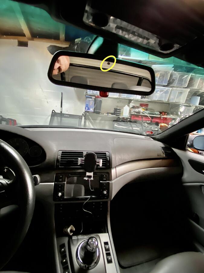

    I sourced a used mirror with an alarm bubble from a local BMW specialised junkyard. It was a EU spec E92 coupe. I couldn't use just the glass because the sizes were different and also the light sensors both for inside and out had different locations. The newer models have the inside light sensor in the mirror while the old ones from Donnely have them on the board and it sticks out at the bottom. So the whole frame is different.

    The important part here was that it looked like the dimming part of both mirrors were using the same color coded wires. They were just in different positions. The connection labels on both mirrors boards were identical at their respective positions though (IGN, GRND, REV/AI) (I only took picture of the original, forgot to take picture of E92 one).
    So I thought I'd swap the connectors and make sure these three wires would go to the right positions. The original and E92 connectors details
    And when the original alarm/radio/antenna board seamlessly fit into the housing instead of the E92 one the rest was history.
