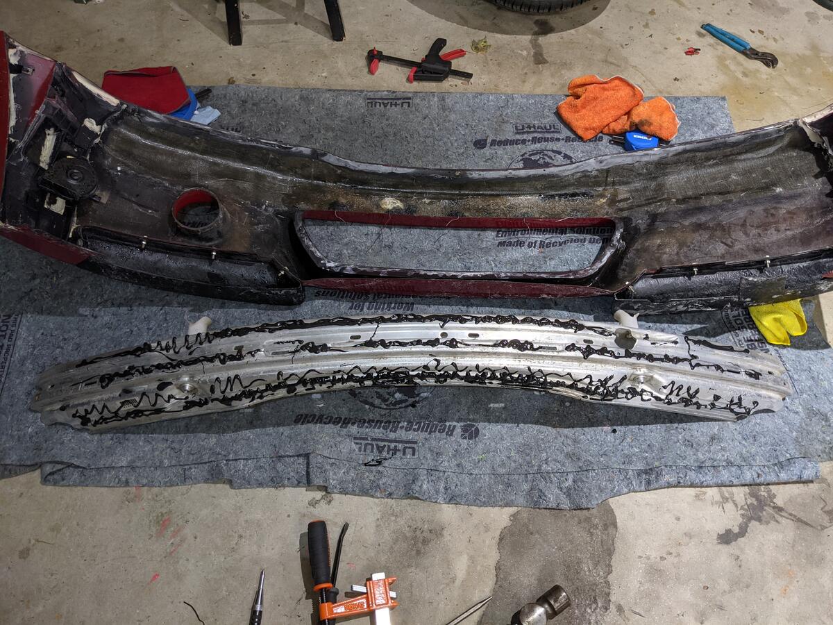

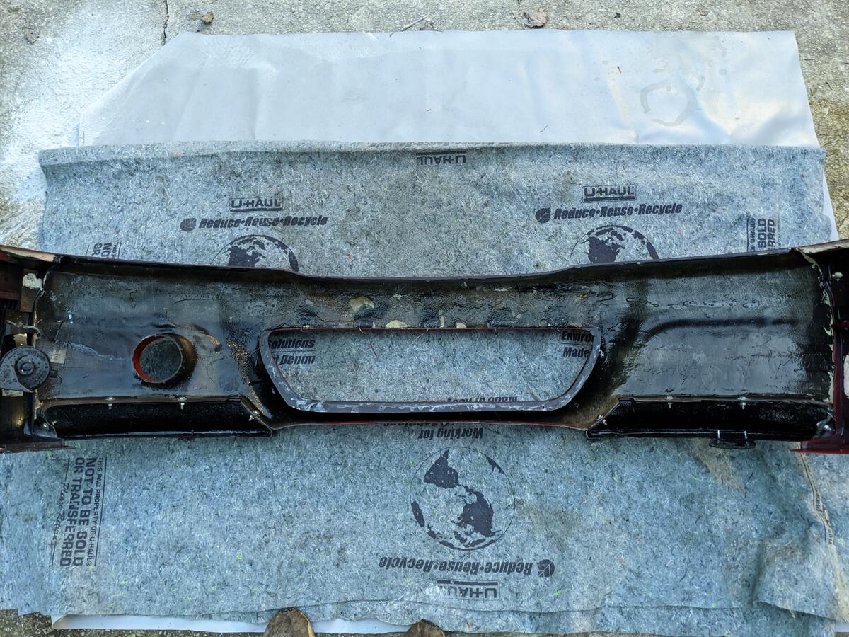

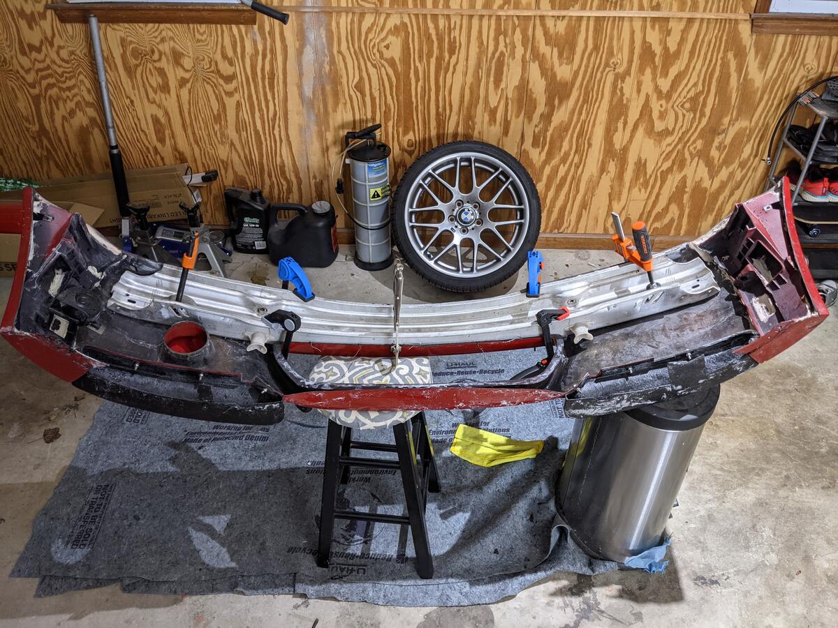

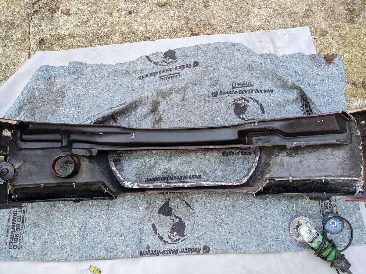

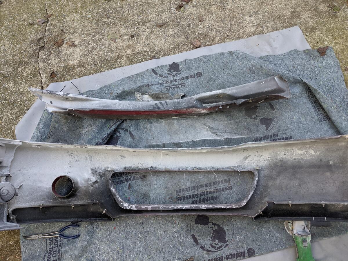

                              Today I went ahead and just decided to yank the bumper off and cut out the built in fiberglass carrier. Wasn't as bad as I thought it would be. A little grinding with a flap disc wheel and they aluminum carrier slipped in pretty good.
                              There's some unevenness on the inside and l walls so the aluminum carrier rocks back and forth left to right.
                              I just used panel bond and clamps from when I did the CF roof. I'll let ya sit over night.
                              I did test fit before panel bonding it to make sure it fit. The lines and gaps were much better
