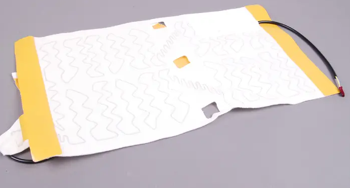

    My question is, since you cannot buy e46 heating elements, but you can buy new e36, e39 and e92 heating elements, do any of those work?
    e39 elements work and can be purchased separately.
      Good to know... Could I get two of the bottom elements and plug them both in?

          Planning to fit E39 heat elements into my pole positions. Will report back how it goes.
          Sent from my HD1905 using Tapatalk
            I just bought part # 52108253115 we'll see what happens in 2 weeks when it gets here
                  Any update? Got my seats but I'm still waiting for my mounts and heat pads. Just thinking about how to fit the pads into the cushions.

                          Got the E39 elements part 52108253115 but unfortunately it doesn't seem like these are plug and play. I'm not seeing how this red plug is going to sit in the yellow seat harness plug. I don't mind cutting and soldering but if I want a "clean" install I'll probably source a junk heated seat just to borrow the harness plug.

                            You still need to make or borrow the piece of the harness that goes between the heated seat elements and the yellow plug. I bought used E39 seat harnesses on eBay and ripped them apart to source all the right connectors to make two new slimmed down harnesses without cannibalizing my own stock seats.

                              Hey Davis… just checking in to see if you had any update on this. I’ve recently been acquiring all the parts needed to retrofit heated seats. Last piece of the puzzle is the heating elements. Not sure if I should try buying E39 elements are sourcing E46 elements from old seats.
                              If the E39 elements were plug and play I’d prefer them because they’d be new. If not the used E46 units might be easier and factory install.
