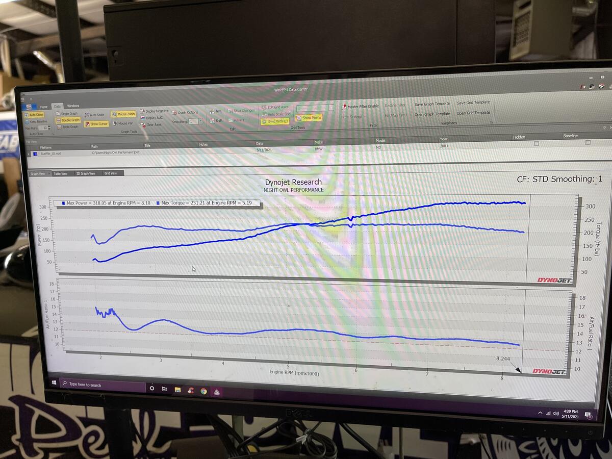

    Previous setup put down 318whp and 231 wtq on a dynojet with STD 1 correction.

    The current dyno chart from the old setup.

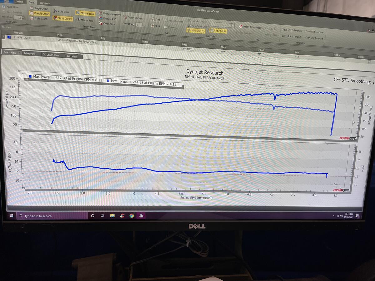

                      So update: car put down 317 and 244. There’s an odd dip in the power band between 6700-7000 that we’re having trouble diagnosing.
                      Power band up until that point is good, once the dip occurs, the inconsistency starts to kick in.
                      Vanos and valve adjustment have been done, and HTE tried reducing timing and vanos pressure up top and still ran into the same thing.

                      At this point I’m thinking it may be low compression, and possibly an old clutch? It’s frustrating yes, but it seems like there should be a resolution somewhere, just need to pinpoint it.

                        I agree those numbers did seem low at the time. Now that I managed to get more torque and roughly the same power, my gut tells me that the limitation is no longer from the hardware.
                          There's something wrong with your car man.
                            It's also super jagged. Something is up..
                            And more jagged than before, with the same smoothing factor.
