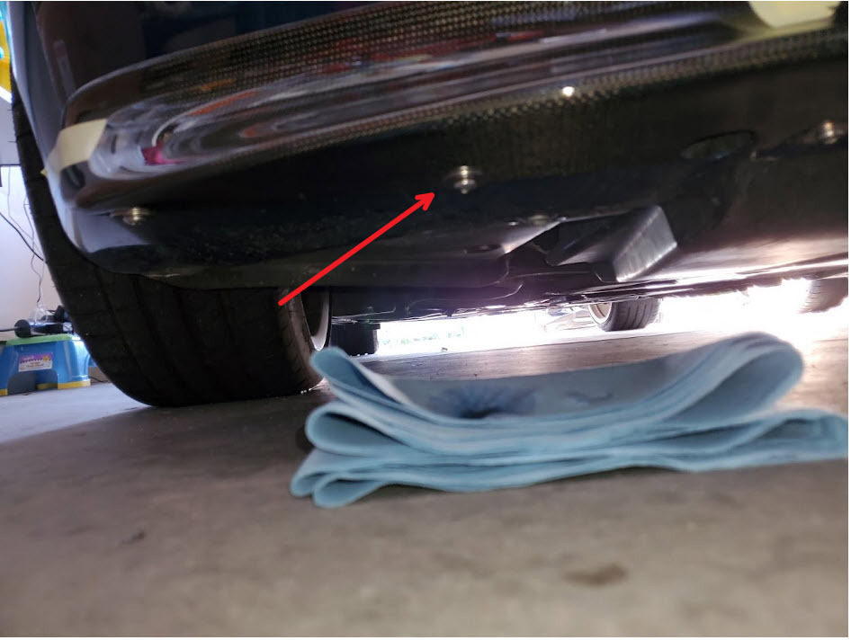

    Checking if anyone know of cleaver way to seal the hole made from drilling into the washer tank, without removing the front bumper.
    Idiot i am, i should have checked first, before doing the splitters install.

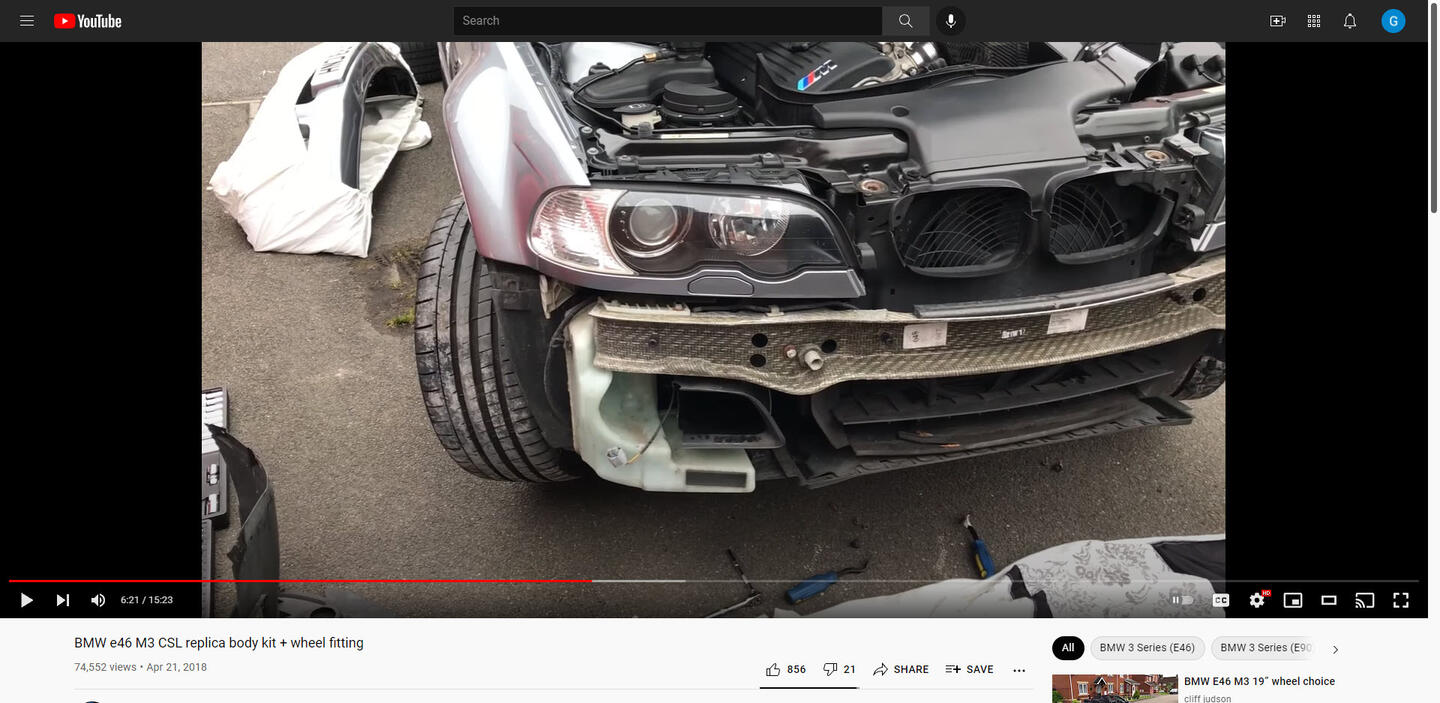

        you're prob better off just replacing the tank....i forget if you can remove it from the fender well area, as opposed to removing the bumper.
