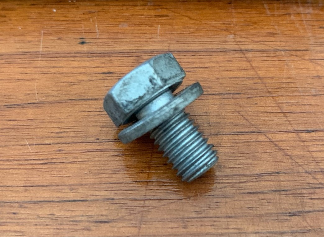

      Sorry to bring this back
      I lost that ground wire bolt, does anyone know the part number?
      It seems to be a M8 bolt

          Its M8x1.25mm but I can't recall the length, short, something like 12mm IIRC.
          I can pull one of out an engine in a bit and double check the length.
            Thanks !
            I tried with the heatshield bolt (M8 x 14), i couldn't turn all the way in with a few threads remaining, so yes it is definitely shorter (may be M8x10 or M8x12 ??)
            did yours come with washer attached as well ?
            can you also take a picture of it?
            The closest i find is a M8X12 crankcase pulley bolt (07119900271​), but not sure if the shank length is too long for the grounding terminal ring.
              I think that one would be fine.
              I pulled a bolt out of a clients car, but it looked long. It works properly and measured 14mm length measure from under the washer.
              I then pulled one out of my car and it measured 12mm length from under the washer.
