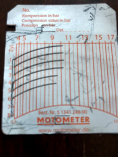

    Removed the lid yesterday and measured the compression.
    1-4 10.5 bar 5-6 9,5 bar

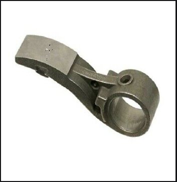

    I noticed that my 11337833259 rocker arms (do you say so in English?) Are retracted.
    I think my cylinder head gasket is not always tight? The clack comes from the rocker arms.

    You possibly have a head gasket issue, based on compression results.

    Not sure what you mean by rocker arms are retracted. Retracted to where?
    Initially I was going to suggest a valve adjustment, which might still be needed, but your compression results are on the low side and below spec, even for 1-4. Spec is 160psi (11bar), with acceptable variation of 7psi (0.5bar).

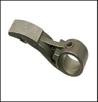

      PMW Part 11337833259 Rocker Arm? Sorry I don't know the common name in English? Many have job vacancies.

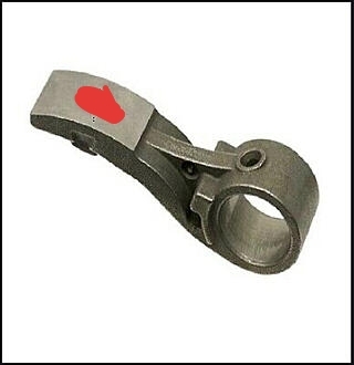

        Yeah I understood what the rocker arm was, I just didnt know what you meant by "retracted". Did you mean it has an indentation and wear where I marked in red?

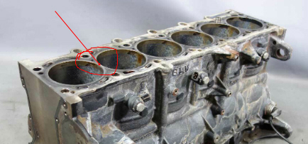

          Click image for larger version  Name:	Block.jpg Views:	0 Size:	75.8 KB ID:	14168 it is the bridges that go through.
          I looked at the Rocker arms van cyl 4,5,6 and they were all flat on the red spot!
