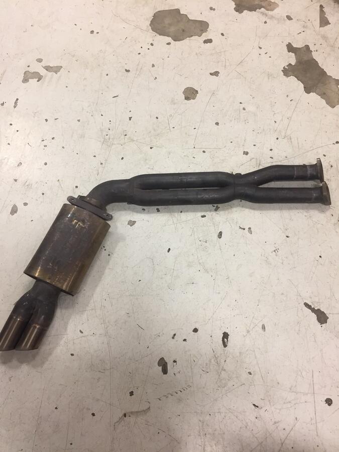

        The reason I question this Is is after looking at the p54b34 engine exhaust design.
          Yes that is the legitimate one from the gtr/ptg cars.
            Side exhaust, race exhaust, Im surprised to see a "muffler" on that. I mirror what Tbonem3 said. But fitting that to a car would be mega cool, that and doing some dyno runs, diagnostics.

              Only had a muffler on noise limiting tracks
