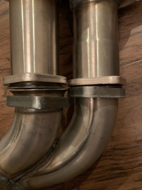

                          So I did my first inspection of the parts how’s this for defects:
                          This is on the connection point of then muffler and section 2. The defect in the metal is on the muffler flange.
                            Man what the fuck is going on with supersprint.
                            I should email those guys pictures of all the issues.
                              Massive disappointment after waiting for over 6 months to get these parts. The headers appear ok, but with these defects who knows if the bends are ok and the exhaust parts will clear suspension and chassis.
