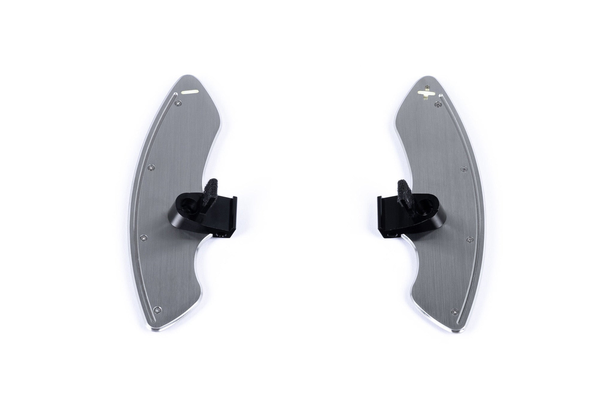

        Storm Motorwerks BMW E46 M3 Extended SMG Shift Paddles. Machined from stainless steel featuring illumination. These shift paddles are extended and provide a high quality replacement for the original

                I wish these were still available:
                These are perfect.
