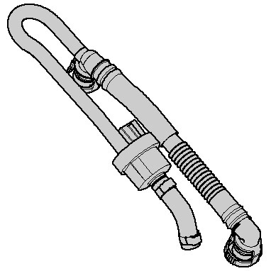

    can anyone explain me the reason that LCI M3 get the vent hose with the electronic valve, vs the pre facelit models have only a regular piece of pipe
    also can i get rid of it without any engine codes poping up?

    I’m planning to do that (well, run a catch can that I was using on my 02 on the 05 I bought recently). You would also at least have to plug the hole on the air rail (or get an early model air rail)
    Theres some good info in this thread: https://nam3forum.com/forums/forum/m...-breather-tube
      in that case i will be ditching that POS and replacing with EU air rail as im going the velocity stack conversion route anyway
