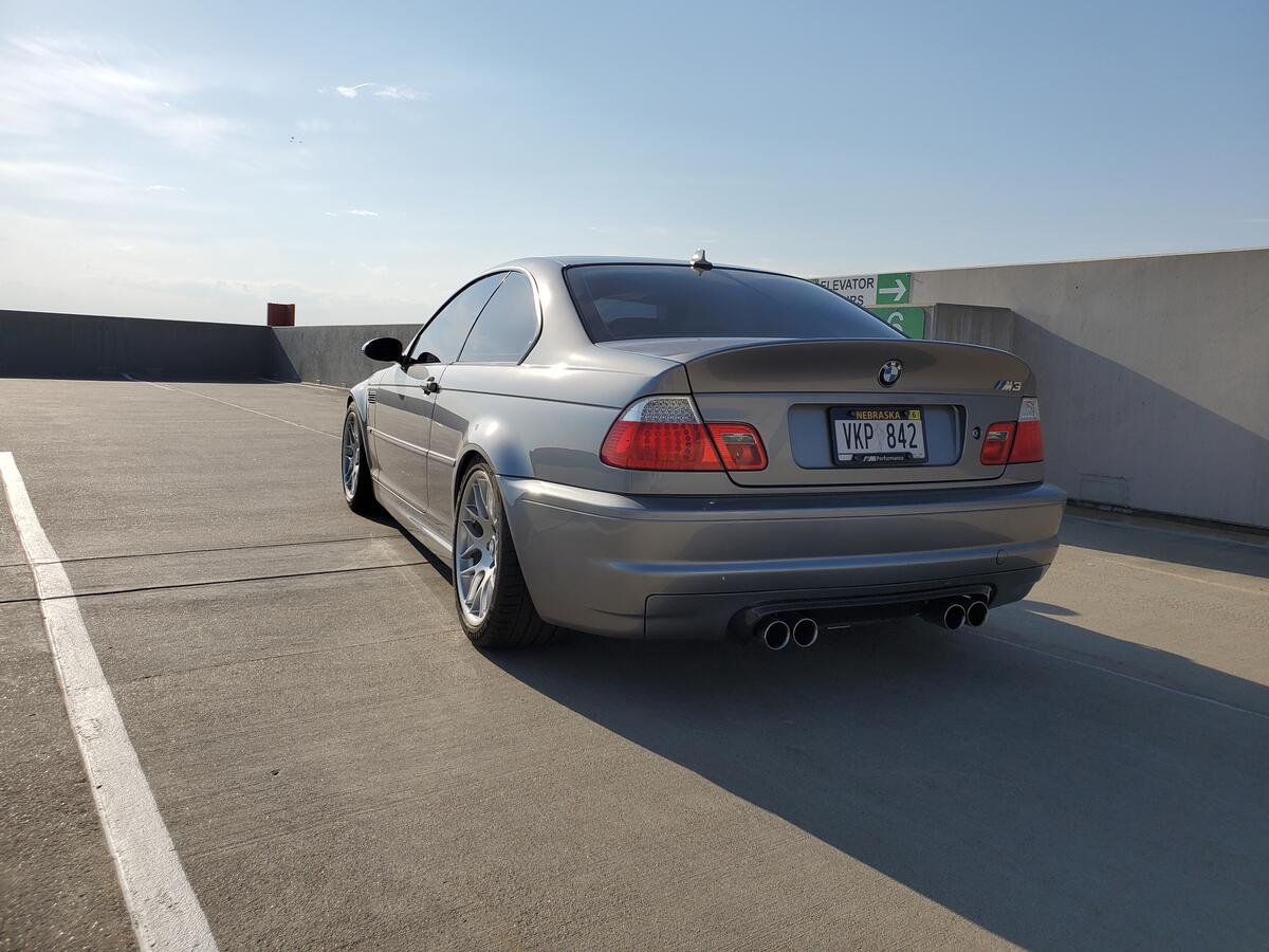

    I have the same muffler with the same tips (polished, looks great imo), I also have one of the "happybuyitnow" ebay csl style diffusers and there is plenty of room for adjustment on the tips provided you clock them just so.
    Unfortunately when I received my muffler the tips had the same inner diameter as the muffler pipe itself so I had a muffler shop swage out the tips. I'm not sure how far the tips would have stuck out normally but mine stick out a tad further than the stock tips.
    I hope yours aligns O.K, I had to stack 7 washers (~1\2") between the vehicle and the OE muffler mount on the passenger side to get the muffler to sit level. I Finally bought a R.E muffler mount for the passenger side #1 so the muffler would stop banging into the EVAP canister plastic surround and #2 so I could ditch the washers as the R.E mounts come with real shims and have back/forth adjustments.
    I also had it raise the point at which the Sec. 2>3 connection is made necessitating the removal of the Sec. 2 heatsheild as it was making contact with the diff. OPF.
    Other than the fitment issues and a shitty long wait with terrible customer service I do like the muffler!
    I don't have any great close up pics but the happybuyitnow guy used photos of my car on the website so you can get a better look.
    EDIT: I want to say I had 82mm tips, but I don't see them listed as an option, in any event they are the double-walled polished stainless.

    Click image for larger version  Name:	20210423_175936.jpg Views:	0 Size:	119.2 KB ID:	139474

      Cubieman Thank you for your in depth review of the exhaust. I checked out the link and your diffuser fits better than my SG one haha! I’m very familiar with shims as i had to use shims on my billy boat b&b exhaust once I modified the tips. I don’t remember how many shims were used, but it was quite a few. Maybe it’s time for me to invest in the rogue muffler mounts as well?
