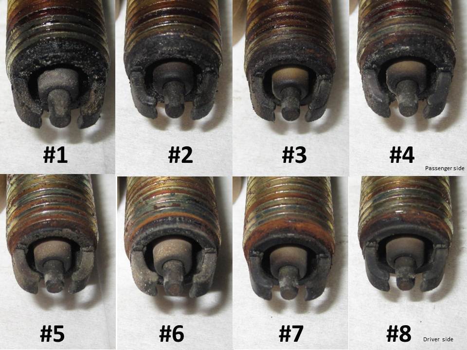

          A cheap way to determine if altitude is affecting your A/F mixture, periodically remove a spark plug or two, and look for excessive ashy grey/tan colored residue, or worse yet, see below. If your plugs have this appearance after operating your car in its current location for a period of time, then retune, and get a catch can while your at it. 🤣😜. Next test, after your M is operating in a closed loop, meaning the O2 sensors are governing the A/F mixture, take a brief whiff of your exhaust to detect the strong odor of unburnt hydrocarbons. If your sled is negative on all counts, perhaps save the money for a rainy day fund.
