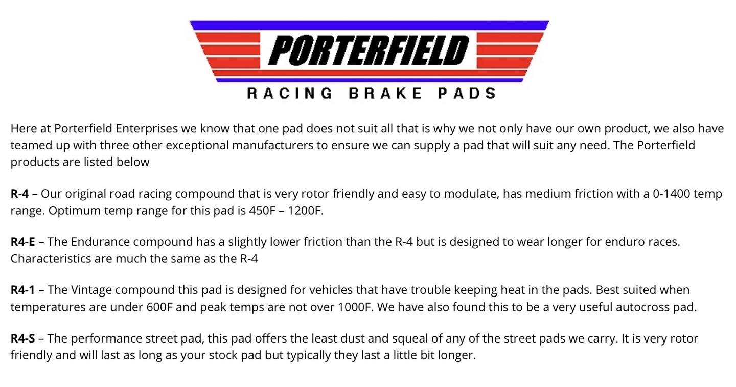

    These are my fave brake pads. Their R4-S pad is a good street pad; it does not squeal like Cool Carbon pads, and they modulate well. As for dust, well, after some hard use they’ll put a light grey hue on your wheels. I’ve used these R4-S pads in autoX and some track use without them giving up the ghost (at the track, I’m not full steam ahead - damn the torpedoes type of fella; the thought of wrecking holds me back, especially on long & fast bends where too much early throttle will get you.)
    If you’re going for near maximum attack, drop in some R4-E pads. These will bite hard, and they’re grabby if you’re not easy on the pedal. These will squeal by the way, but that’s a car guy’s badge of honor when you want to get down with serious braking. Porterfield pads are moderately priced, unlike Pagid Yellow RS-29 pads, which calls for you to open your wallet very wide.
    Right now though, I’m using Ferodo DS-2500 pads in my Brembo calipers. The fella at Zeckenhaus (sp?), the brake pad+rotor vendor, recommended these endurance type pads, and I like them. I seem to recall him saying these are a direct replacement for the Ferodo pads that come stock in a new box of Brembo monoblock bbk. These work well in my 6 piston front calipers and dust output is on the same level as Porterfield’s street R4-S pad. These occasionally squeal during ordinary street use, but it doesn’t bother me. I would say, these marginally grab more with light brake pedal application, over the R4-S. Sorry for being wordy. 🥴
    Click image for larger version  Name:	27F52B06-D06D-4E70-A905-76C718F3BF39.jpeg Views:	0 Size:	138.8 KB ID:	13988
