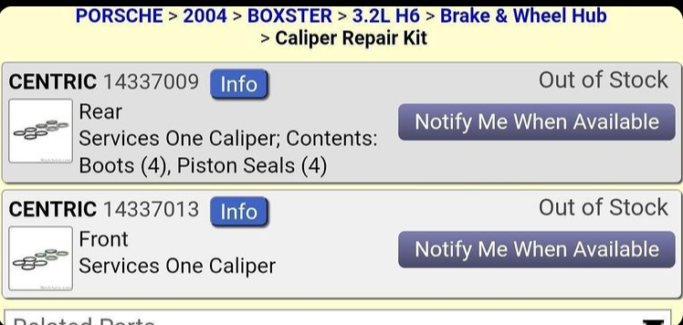

                      If anyone comes across a set of rebuild kits for the calipers please let me know. I appreciate it !!

                        Get rebuild kits from Girodisc, and don’t ruin your fancy brakes with ceramic pads.
