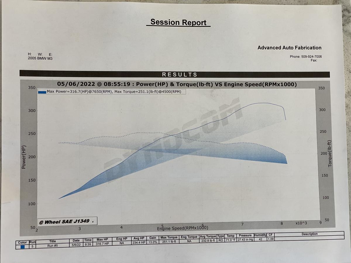

        The car has been sitting for a week since the weekend before last when I took a 600 mile road trip where it drove great. I had it on the Dyno a couple weeks ago and it seemed to make great numbers, although I have no baseline to compare to.
        Should I be worried? I am getting multiple misfires so I have a set of coils on order (I have Eldor coils purchased for my previous m3 3 years ago). Plugs are new, along with o2 sensors and TPS.

            Under load seems ok. That dyno plot is from about 3 weeks ago and I had no issues there, but I get those codes for "Misfire, Cyl N without cutout" on 3-5 cylinders and "Misfire, multiple cylinders without cutout" pretty consistently.
            I drove around to get the oil up to temp to do an oil change and re-tested cylinder 1, and it showed 105 psi with that gauge. I don't know if it was the gauge or my technique or whatever, I think if my compression was that bad on all cylinders I would notice it on the dyno and the butt dyno, so I think I'm probably good to just drive it this summer and then pull the head over the winter.
