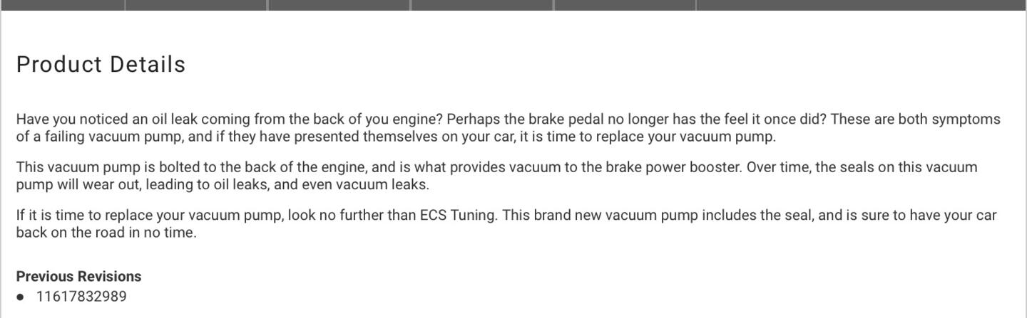

            Second Thoughts - The E46M braking system is vacuum assisted. Perhaps you have a vacuum leak in the system. I randomly looked on ECS’s website and found this... Notice the description below that ECS offers about this part; It matches your issue, BUT I’m not advocating that parts be “thrown” at your braking system; test the part before buying. Again, good luck.
