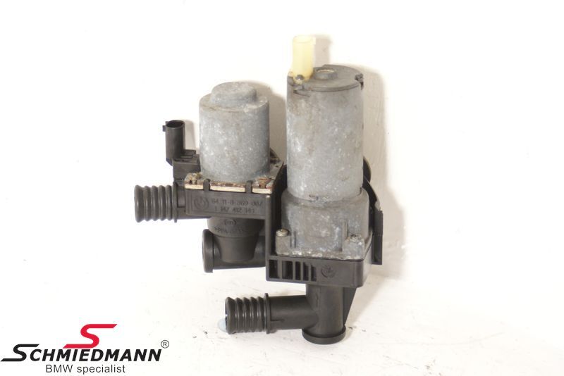

    2. P/N 64118369805 - found on E46 M3 CSL, non-M E46 3-series, and X3 - heater valve only, no attached auxiliary pump
    Click image for larger version  Name:	64118369805.jpg Views:	0 Size:	36.4 KB ID:	14594

    I’m running the non M/CSL version. No notable difference.
    I did code the climate control module (I think it was that) for the alternate pump.

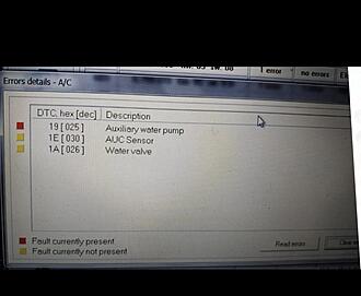

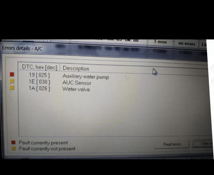

                    I think on the old forums terraphantm had mentioned that on the E46 M3 the auxiliary water pump portion even though it was installed was never actually coded to be used by the HVAC controls module. Even though it's wired in to the body harness I don't actually think it does anything compared to say the E39 M5 and the X5 e53 where it actually does operate like it's supposed to.
                    My E46 ZHP that's been converted has the non-M heater water valve and I've had both HVAC control modules from the facelift cars and pre-facelift cars and not had any issues with it.
                    ***Edit I was wrong sorry Terra! Looks like the hvac module in the m3 specifically is coded for the aux water pump and will display an error code in the hvac module itself of the aux water pump is not present though people that have swapped in m3 hvac modules into non Ms didn't notice any issues with their heat or ac despite the error being present I'm the hvac module itself.
                    Should be able to use ncs expert to recode the hvac module to disable the aux water pump portion or swap in an hvac module from a non M.
