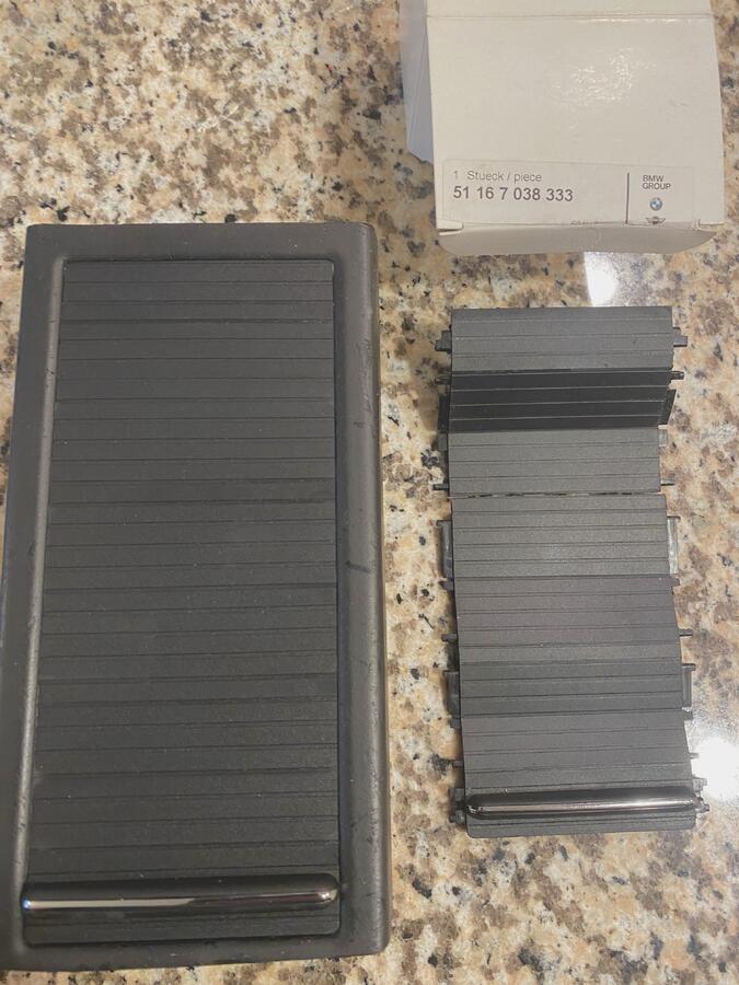

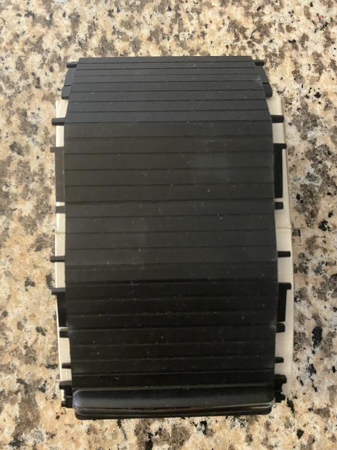

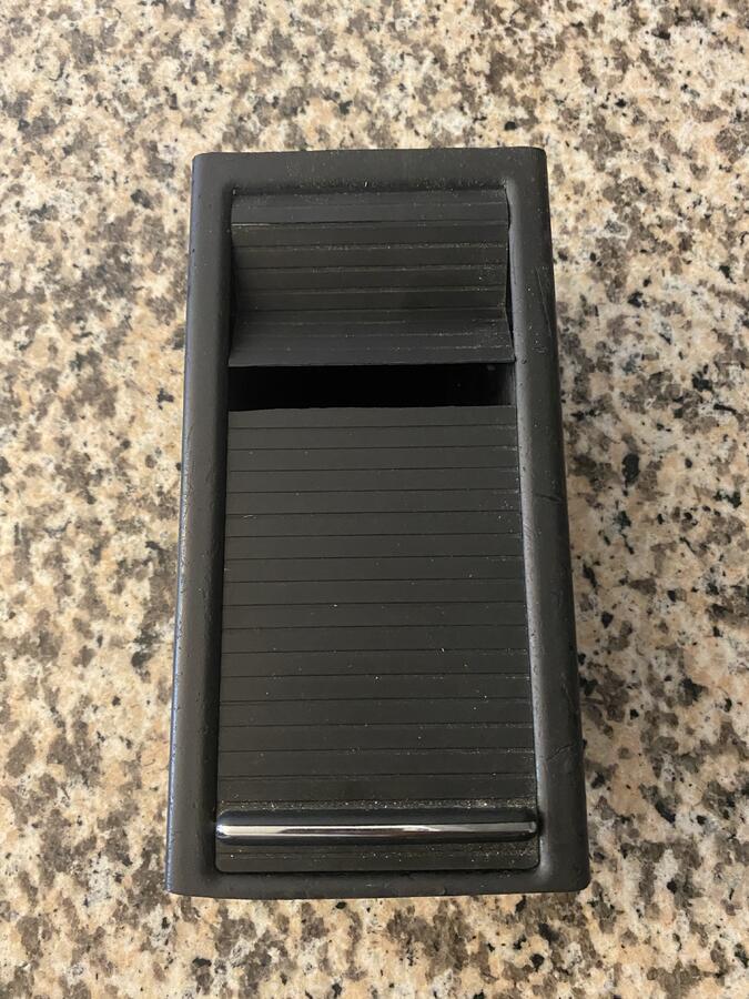

    Some already know about this. But for those who don’t or forgot just a refresher. The euro slider cover can split over time. My last one lasted about 6 years. Yours and use may vary. When it does split you don’t have to toss old and buy the whole new euro tray. The replacement slider is part number 51167038333 *for the shorter euro tray version. ~$17 Takes about 10 mins to replace when you know how it slides out back channel.
    Click image for larger version  Name:	B67BCD91-090A-40E2-94AF-058CED1E80A4.jpeg Views:	0 Size:	116.1 KB ID:	146833 Split

    Replacement Slider
    Click image for larger version  Name:	2FA06D8F-2754-45F3-811F-9036566FCB71.jpeg Views:	0 Size:	87.1 KB ID:	146835 New vs Old
