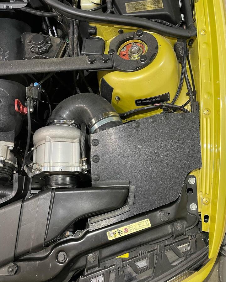

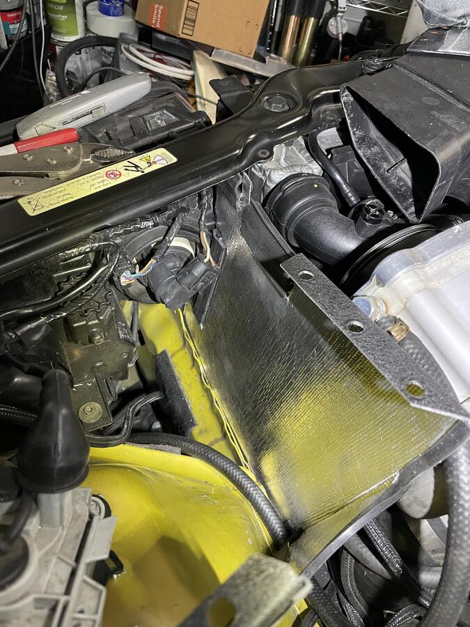

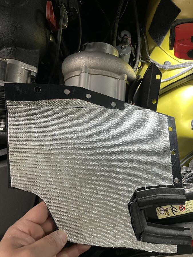

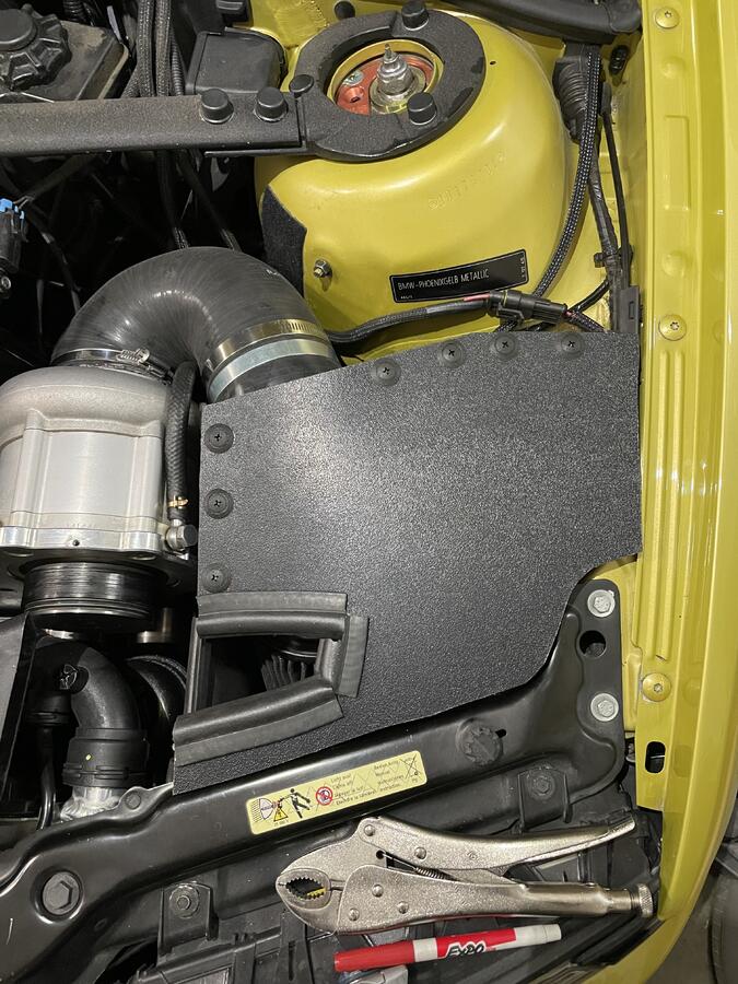

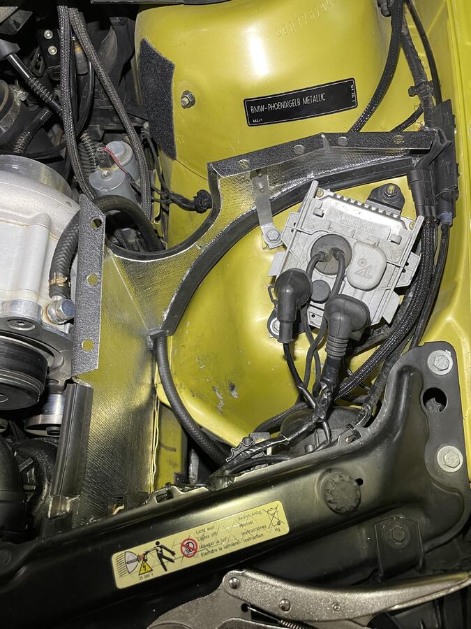

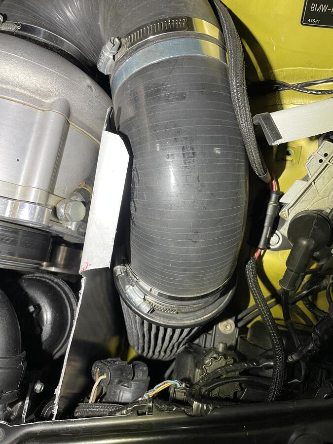

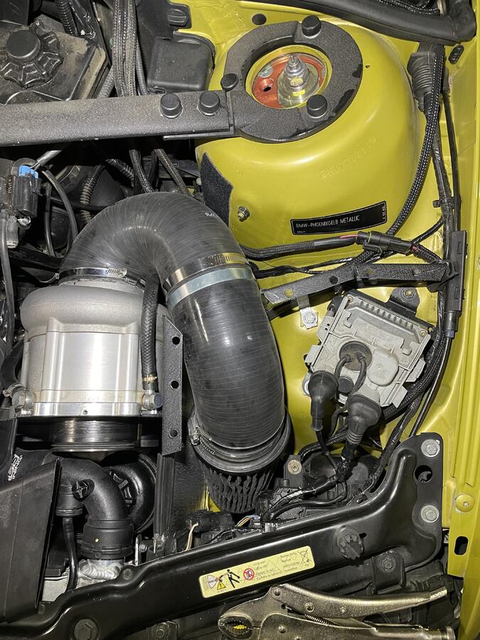

Air filter box inspired by the Dinan CAI. Fabricated from aluminum & ABS. Insulated and sealed to avoid picking up heat from the engine bay. New custom air filter is on the way!!

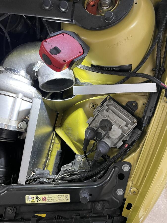

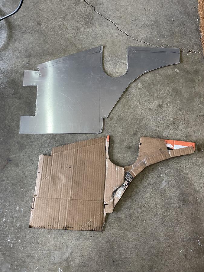

No more worries about water getting to the filter as well
