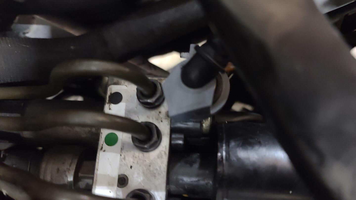

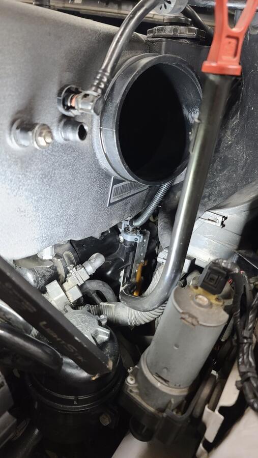

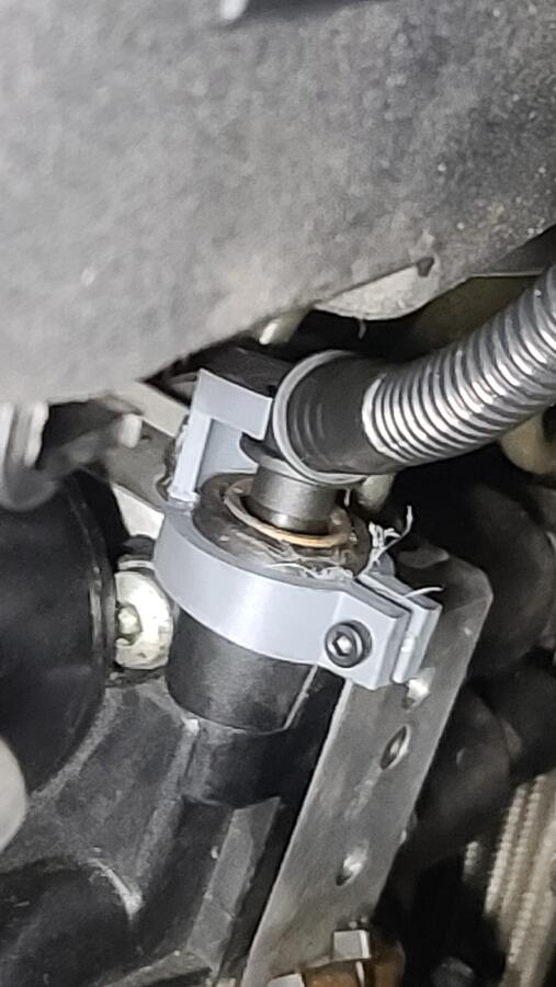

Thought I would post this up I was working on an m3 and when I disassembled it, it seemed like the previous mechanic had an issue getting the hose out as I have with another one from the pump side and broke the retaining clip off and just electrical taped the hose down but I made a solution for it when reinstalling it and would just like to post it in case any one else has the issue and needs a fix for it. Although it still needs a little bit of a redesign it has worked on the car I installed it on. I can send the file to anyone that needs it or print it for them for a small fee.
SMG Supply hose clip broke
