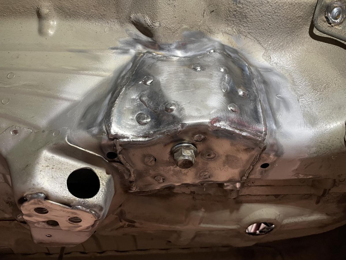

    I went with Redish V3 and the installer was very impressed with them. I have pictures I can share of the install.

      Can you share pictures of the front topside reinforcements after install?
        The Redish V3 plates are equivalent to the CMP reinforcement plates + CMP rail plates. I went CMP reinforcement because they more comprehensively wrapped the subframe mounts than the older Redish plates did - but I don't think there's much in it now with their new version.

                Please do. A big issue with original plates is that they just redistribute to another weak point without addressing the problem. I think if these cover what they should mixed with a Vince bar, that seems like the actual fix. I don't think a Vince bar is unavoidable

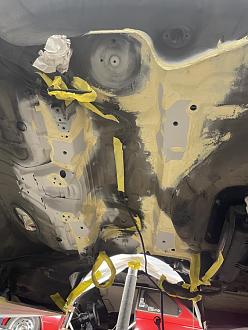

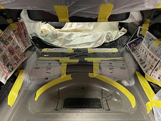

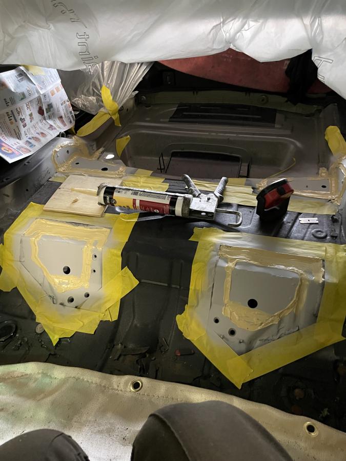

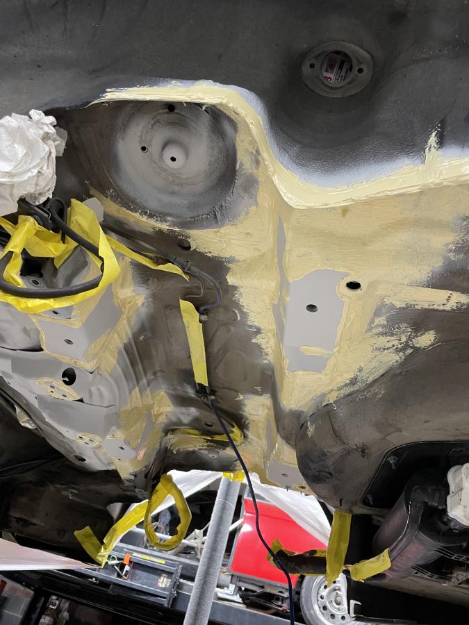

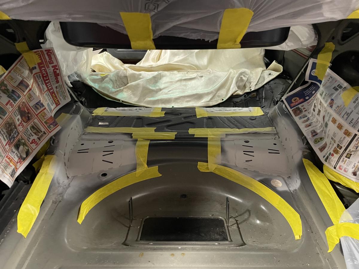

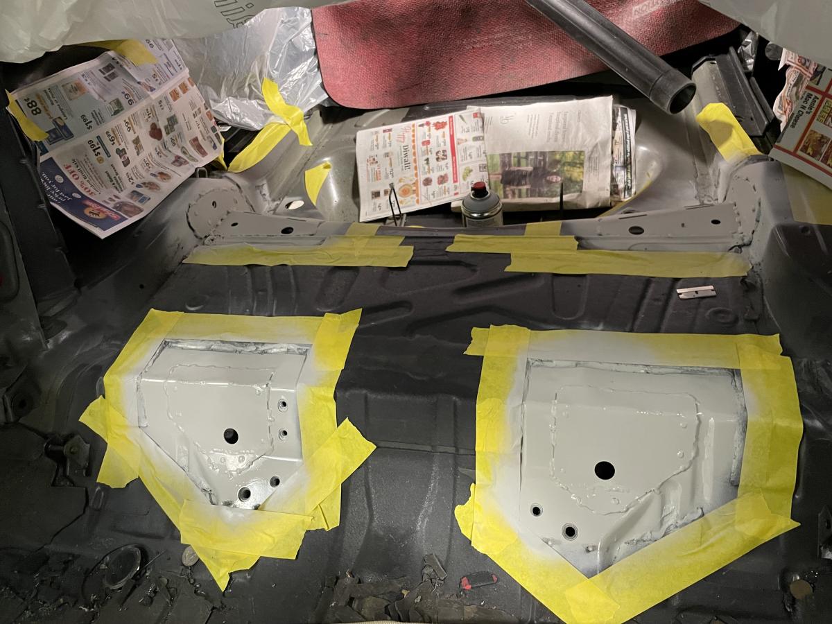

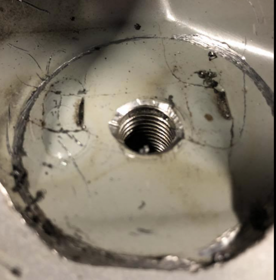

                  Click image for larger version  Name:	IMG_1531.jpg Views:	0 Size:	81.5 KB ID:	150932 Click image for larger version  Name:	IMG_1533.jpg Views:	0 Size:	146.4 KB ID:	150933 Click image for larger version  Name:	IMG_1534.jpg Views:	0 Size:	137.1 KB ID:	150934 Click image for larger version  Name:	IMG_5862.jpg Views:	0 Size:	155.3 KB ID:	150935 Click image for larger version  Name:	IMG_1526.jpg Views:	0 Size:	85.7 KB ID:	150936 Click image for larger version  Name:	IMG_1530.jpg Views:	0 Size:	92.5 KB ID:	150937
                    Just visually, I don't see how Redish's V3 top front plate cover can address the issue underneath:

                      From what I can tell it looks like the front plates serve a similar function to the rear plates over the subframe mount being a cover for the hole you have to cut to repair the cracks on the top welds.
                      The failure found around the front two mounts (excluding the welds themselves shown above) is where the floor meets the chassis rail (spot welds popping) and cracks around the anchor points under the back seats as they seem to be point loads exerting the stress in the RACP on the bench seat sheet metal (the female threads are actually a part of the RACP).
                      I'd say they're structurally similar with the Redish kit offering the simplicity to the installer to use a provided covers rather than tack welding the sheet metal that was cut away back in.
