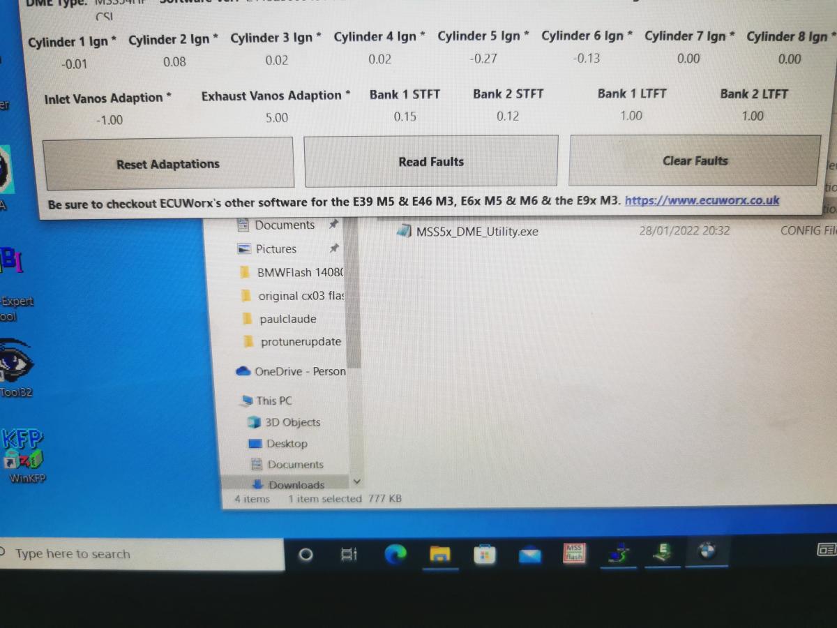

    When checking adaptations with the ecuworx tool, my adaptations show the following.
    ​​​​​ Click image for larger version
    -1.0 inlet (I'd say that's about right for the amount of friction on the pin)
    5.0 exhaust. This is where I'm confused. It's definitely not timed 5 degrees out, so I'm wondering why this is the case that it shows this?
    What are the adaptations, what are they doing/do they do?

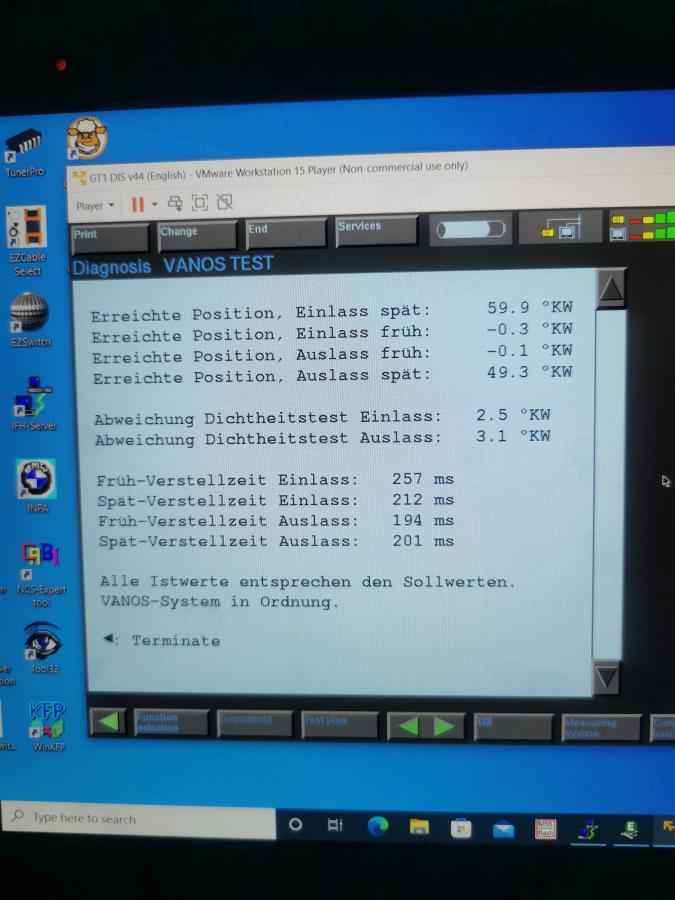

    My DIS vanos test passes fine so this is more curiosity than anything else...

    Just a guess: Noticed the EX was commanded to move to 0 and 49 (most of the reports shown 48), but the vanos spec to have EX working range is 0 to 45. So maybe the EX max retarded position (hitting the piston cap) is 49, but the operating range is [45 to 0], and so DME used the offset 5 (49 - 45 = 5).
      I think we may have a misconception about vanos adaptations as an indicator of engine timing. Yes, bad timing setup will affect them, but for timing verification you used your timing tools during assembly and the VANOS testing in DIS, Tools32 or ISTA after. So, if you did your timing right during assembly and your VANOS testing confirms there is nothing wrong with engine timing you are good, period.
      VANOS adaptations are no different than fuel trims and spark advance/retard, the engine management will adjust based on sensor readouts. My educated guess is that the DME will delay or advance camshaft displacement requests based on what sensors are telling it. For example if the DME says I need 110deg on the intake cam, but it only sees 108 then it will realize it needs more solenoid activation and will request those actions some degrees before or after if it sees the opposite. Based on INPA shown ranges, this can be up to 10deg, now, we all want those values down to zero or as little as possible, but that is our OCD, as long as the DME meets the targets she is happy and makes no difference to it nor to the drivability of the car.

      OP, you made comment on the other thread that you just used one of the pistons from another unit, that is ok, but you mentioned the piston would slide very easily, that is not good and I am surprised you did not change the seals, they are cheap and easy to do and you had the unit apart. Bad decision.
      now, if I am honest, your VANOS results are not bad, timing is fine, response times are good, and the only thing I could say is not ideal is your leak on the exhaust side where the cam drifts 3deg, was this the piston that slid very easily perhaps? But again, tolerance is 5 so is fine still.
      my leak values are in the 1-2 deg, so my adaptations will be smaller as there is less internal leakage. Also if you have a weak accumulator we could see that the VANOS would take more solenoid activation thus a larger adaptation values, particularly during demanding conditions.
          Needs fuel trim because injected fuel volume is unknown — an opened loop system compared to cams timing which is a closed loop system with known feedback measured angles.
          yes, i see the similarities with ignition timing but ignition uses the knock sensors to optimize the spark timing. What does the DME use to set the Vanos adaptation values?
