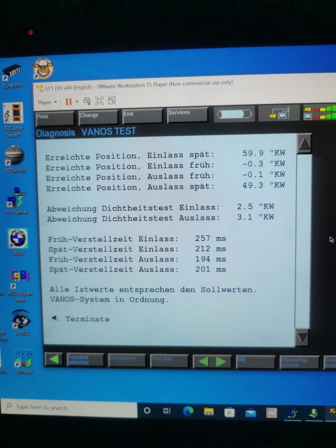

    I did a vanos test when installed.
    ​ Click image for larger version  Name:	IMG_20220128_203103.jpg Views:	0 Size:	71.2 KB ID:	152416
    With okay leak figures... 2.5 inlet and 3.1 exhaust

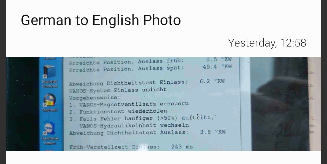

    Failed Once: 6.2 inlet, 3.8 exhaust

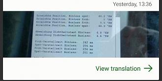

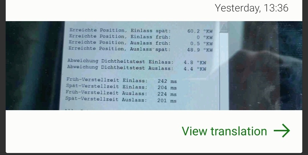

    Then passed with higher figures than the original test: 4.8 inlet, 4.4 exhaust
    Click image for larger version  Name:	Screenshot_20220206_200028_com.android.gallery3d_edit_226228234814958.jpg Views:	0 Size:	86.7 KB ID:	152418
    Ran two more tests and it failed again then passed
    So what exactly are the leak figures? And do they only relate to the seals in the unit? I.e. will refreshing them reduce the leak numbers...
    I ask because the exhaust leak numbers are still high? And that piston has new beisan seals on it?
