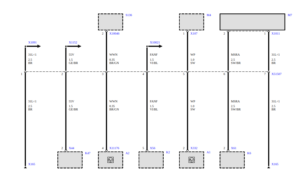

    Has anyone disassembled the male connector of the front bumper wiring harness?
    I am trying to remove all the cables for the washer system and fog lights as I deleted that.
    Thanks!

    Pins 2, 6 and 7 are front fogs and the headlight washers.
    Yellow with a brown stripe, Black with a brown stripe and brown.

      Hi Ted,
      Thanks for the info, but I was looking if it's possible to get the pins for the unneeded wires out of the connector so I don't have cut cable ends sticking out.
      Edit:
      Never mind, I just gently hammered the pins out. Works good without damaging them.

        Ah, the proper tool would be one of these: https://www.amazon.com/dp/B08295ZWL2/
