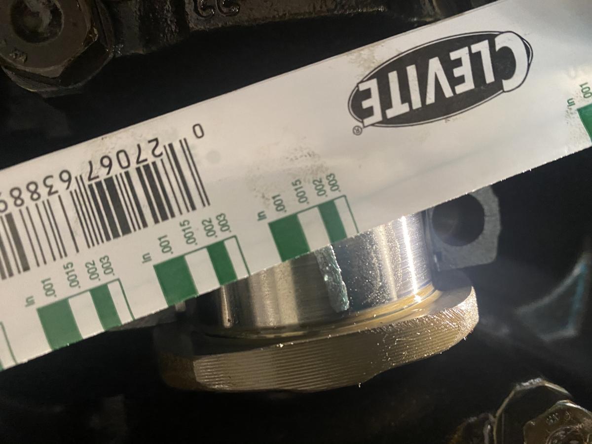

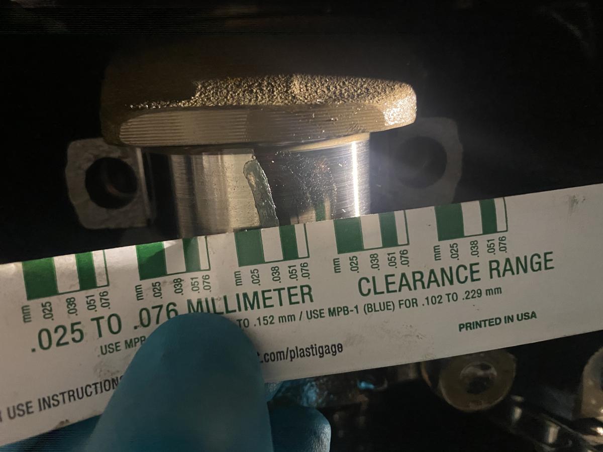

    Does anyone know the oem rod bearing clearance I should be looking for. Getting conflicting data out there Click image for larger version
ID:	154344 Click image for larger version
    Let me check ISTA.
      .030 to 070 milimeters which translates to .0011" to .0027".
      Looks like you have perfect clearance.
