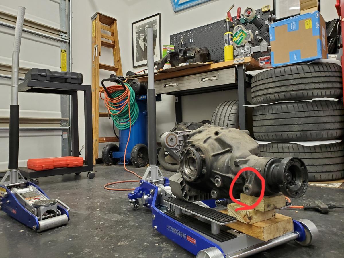

                Diff. could stay in for pinion seal I would imagine, and yes 3 bushings, 2 in the rear and 1 in the front. The front bushing is on the right hand (pass. side) towards the front/bottom portion of the diff.
                Edit: Here is my diff., in red is the female threaded portion for the front diff. bushing.
