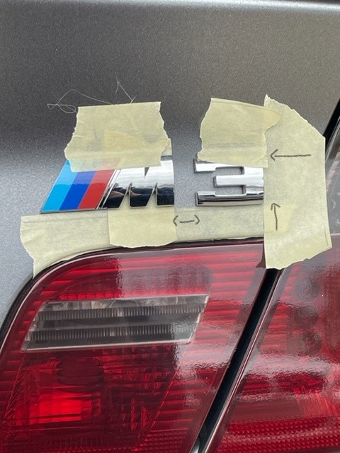

    Hi all - Can someone do me a favor and provide measurements for the M3 trunk badge on a M3 convertible? I found a few posts however none seem to be accurate. I used the following measurement found online:
    16.8mm - Up
    10.8mm - In
    10mm in between the M and 3
    However it just doesn't look right?
    Can someone please provide measurement off your M3 Convertible.
    Cheers!

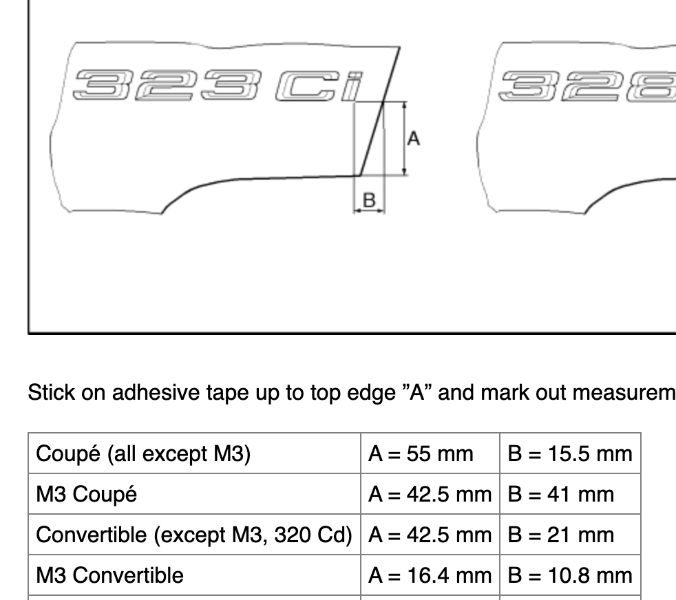

    From my 2005 I'm getting:
    11mm - up
    23mm -in
    8mm in between
    Up and In measurements are from the edge of the trunk lid fold, not the gap.
    Hope this helps.
      On my 2005, I'm getting:
      16mm up
      24mm in (top of 3) / 13mm in (bottom of 3)
      8mm in between (measured from the top of the M and 3 relative to the mounting surface, each are slightly tapered)
      (I measured mine from the gap, not the start of the fold.)
      2005 E46 M3 | Vert | Manual | Carbon Black / Cinnamon
        A = 16.4mm
        B = 10.8mm
