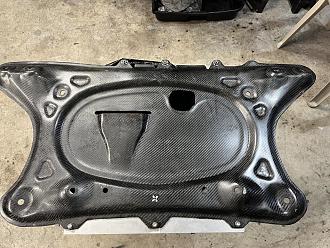

    This is the neat part of composites...you can target reinforcement and change the properties by using different weights and weaves of fabric.
    On the bottom of my splitter...I laid up strips of unidirectional tape front to rear under the bottom layer to provide more stiffness in that direction only. Again, twice as stiff as using a twill weave and less epoxy consumption. I believe this to better optimize weight vs using more layers over the entire splitter or bolting on aluminum L channel.
    So I would like to apply this targeted reinforcement to the front plate. Any input is welcome!

    Thanks. I'd probably use an infusible soric core away from the bolt holes if that's the route I go. I need a better understanding of how the plate will potentially flex. For example, I used unidirectional fabric in certain areas of my front splitter instead of just adding another layer of 2x2 or biax cloth. Unidirectional is the stiffest fabric in one direction, twill weaves split that stiffness in half in two directions. When I laid up this plate, I alternated between a 2x2 twill and a biaxial cloth.
    I should be able to save up to a lb and achieve similar stiffness as 9 layers if I can lay up 5 layers of alternating 2x2 and biax and place 2-3 layers of unidirectional fabric in key areas.

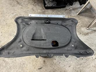

    Finally an update! I’ve put 12 days of track use on it, car pulls up to 1.61 lateral G’s according to my AiM Solo DL. The plate has survived. I won’t say that I noticed a huge difference but I did set PRs on 3 track configurations.
    I was concerned that the front edge of the plate where the aluminum c-channel is bolted wouldn’t not be strong enough to take the loads of the splitter. Turned out fine.
    Only change was I ended up bonding some fasteners to bolt the underbody panels too.
    Click image for larger version  Name:	ECDCB196-D9DF-41D1-9749-EC838D8B19FC.jpg Views:	0 Size:	266.3 KB ID:	195876 Click image for larger version  Name:	67452A65-0DDF-4AC8-B4A2-DD27606B6E88.jpg Views:	0 Size:	227.9 KB ID:	195878
    No concerns with damage around the bolts. Just the normal galling from torquing up the bolts.
    Click image for larger version  Name:	09D111C0-41A2-4D5C-916F-F4E36700CB41.jpg Views:	0 Size:	303.8 KB ID:	195879
    Click image for larger version  Name:	524587BA-1222-488E-A2BC-EFF52B92EEA6.jpg Views:	0 Size:	303.2 KB ID:	195880
    Click image for larger version  Name:	26341DE8-8880-49A4-B29F-7BDEF12EC150.jpg Views:	0 Size:	356.1 KB ID:	195881
    Click image for larger version  Name:	DB6DB7ED-EB97-4CEA-B3C2-65479C508A65.jpg Views:	0 Size:	344.0 KB ID:	195882
    There is one spot where the export yellowed. Right near where the exhaust manifolds pass by the plate.
    Click image for larger version  Name:	8ADB2D34-F931-433A-A5AF-A30CF261AEE6.jpg Views:	0 Size:	203.3 KB ID:	195877
    Overall it’s a success!
    I’d like to see if I can improve the stiffness and make it lighter. Might use 2-3 fewer layers of carbon and add targeted pieces or incorporate an infusible core

    I took it for a spin around the block. Felt about the same...a good thing. Inspected it and everything looks good. I hope to get it on track Apr 9 with Chin Track Days at MSR Houston to test it. The plan is to drive withe CF plate during the day, inspect after each session. For the happy hour, swap in the aluminum plate, drive a couple of laps and then swap in the CF plate and drive some laps. See if there is a huge difference. Not really expecting to be much of a difference. Mostly want to test how well the plate holds up. Specifically the front tabs where the front splitter connects to.
