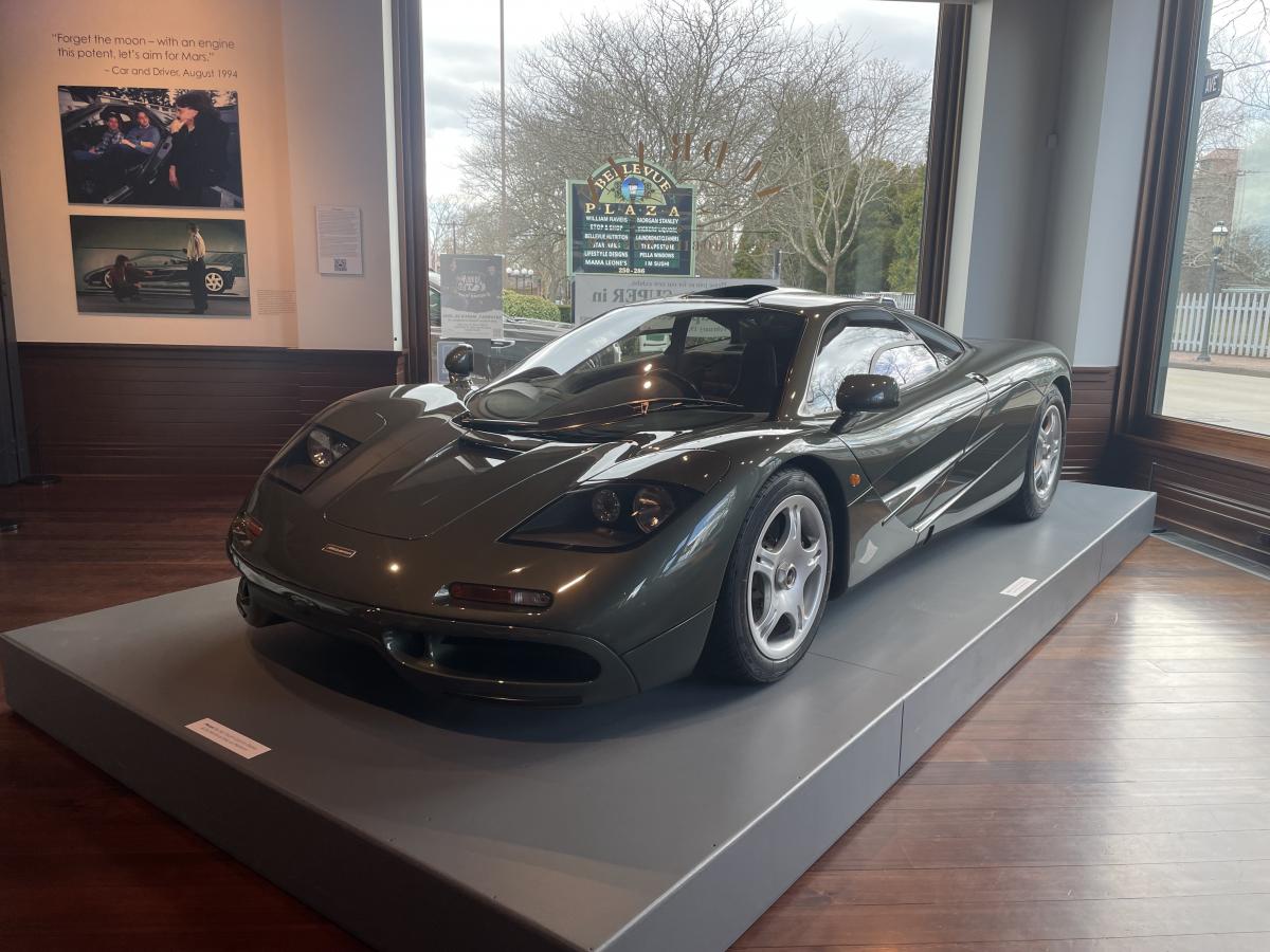

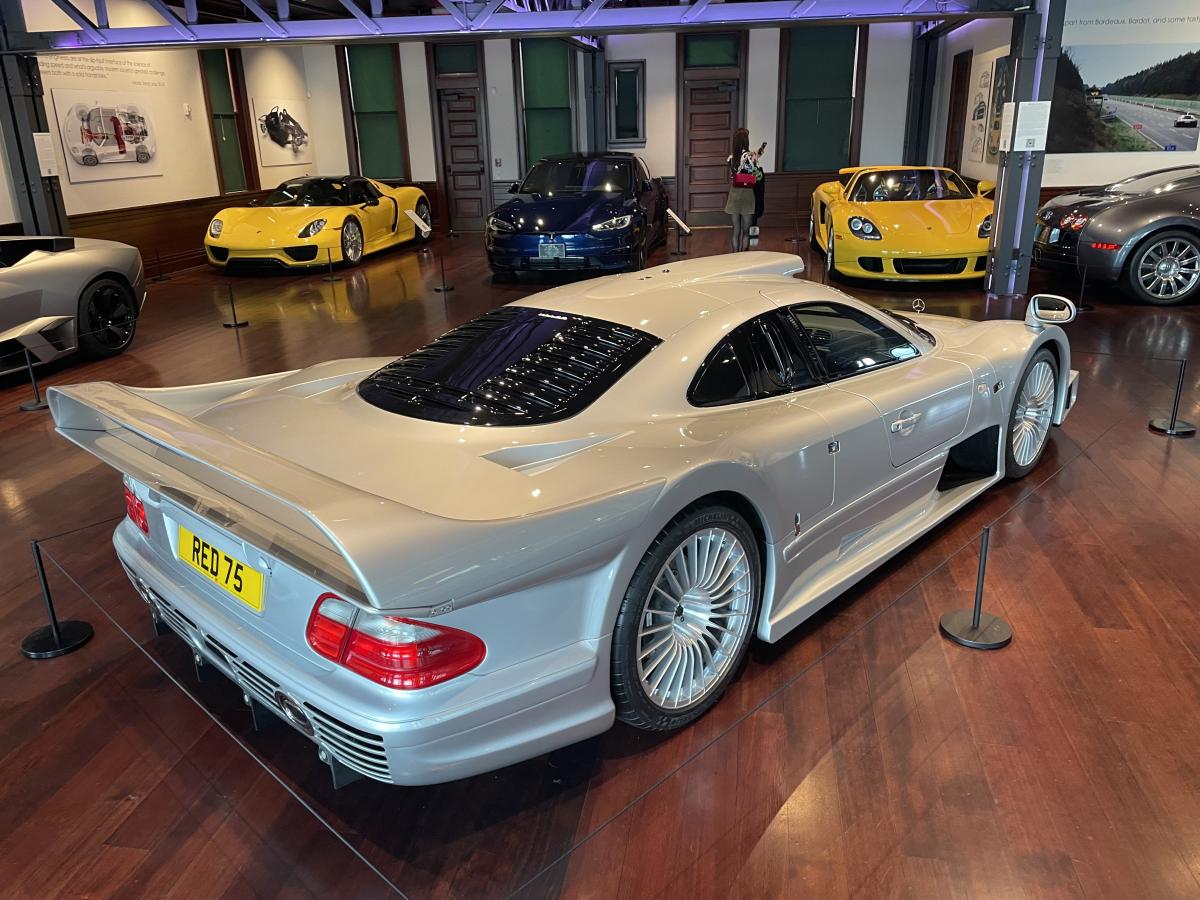

    This past weekend, I took the M3 out for its first proper drive of the year. In the fellow company of my buddy's E39 M5, we did a ~300 mile loop from southern NH down to Newport, RI to specifically stop by the Audrain Auto Museum and check out the McLaren F1 and CLK-GTR that they had on exhibit. I had been fortunate enough to see both examples of the F1 and GTR running and up close at Amelia Island Concourse D'Elegance in 2021, but definitely wanted to see them again while they were local and a great excuse to take the Ms out for a day trip.
