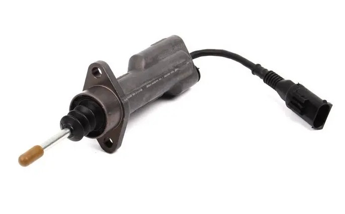

            Had similar issues and eventually started seeing the cog light on the dash. A new slave cylinder (21522229841) fixed that particular issue for me. Also, don't know how many miles you have, but if you've never replaced the clutch and all associated parts (the main culprit that triggered my clutch change was a busted throwout bearing), you might be due.

                I had no codes...just the cog light. Its a relatively easy install...a couple of bolts and removing/re-attaching the hydraulic line. Just have to run the INPA bleed procedure again afterward.
                If you don't want to spend a lot on a brand new unit, look on ebay for a used one that looks as clean as possible (nylon tip still rounded/proper color with lowest miles). I picked one up there for $50 and its been working great for 3 years. If you replace the slave for a relatively cheap cost, you'll at least know if its the issue before having to open up the transmission, etc. Just make sure you look for the SMG slave as it is different than the one on the standard 6 speed.
                Obviously I don't know if this is your exact issue, but wanted to leave some info here for anyone that might run into similar symptoms down the road.

                      Mine had an issue where it felt like a slipping clutch. I had the car serviced, the clutch is hanging on my wall in front of me at about 50% life. After looking over the parts, the Slave cylinder was to blame as the tip became worn. I'm glad the whole job was done with a new clutch, cylinder, bearings, rear main seal. guibo, csb, fork and pivot pin. You can likely get away with a new slave cylinder but the whole system should really be serviced whole.

                        If the slave pushrod is shortened then clutch should have issue of not disengagement instead of slipping.
                        In this case I wonder try to relearn the computer might solve the problem as this teaches the computer the new worn slave rod position.
                          It felt like a worn clutch when shifting and would slip out of first. All other gears grabbed fine, even under torque. This was the main reason I did not suspect a worn clutch.
                          I believe the worn slave cylinder tip caused the position sensor to provide a faulty signal, messing with the other two linear actuators. A soft-software reset (holding back both paddles above 40mph in neutral) solved the issue but only briefly. I also had the adaptations reset during a re-learn before I did the clutch job.
