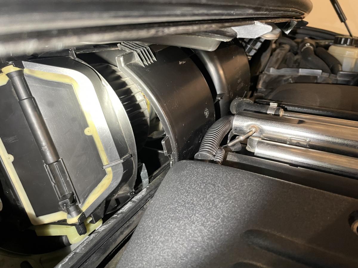

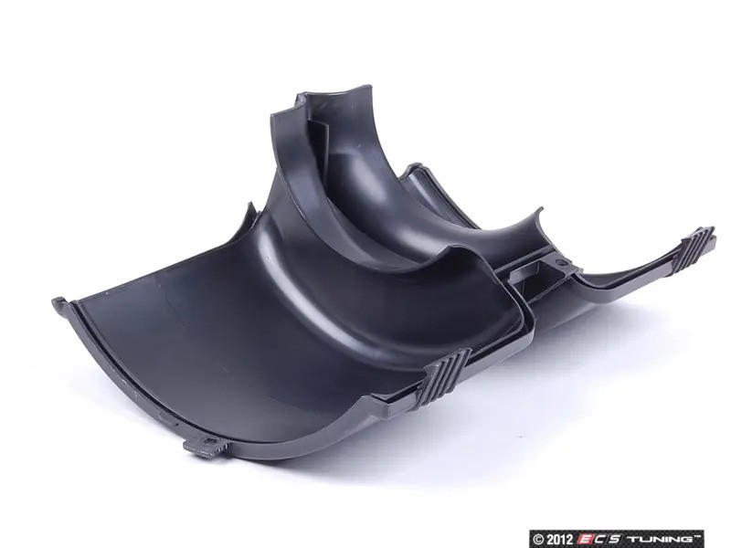

    The concave extension that juts out on the back is snagging on everything. I can't seem to wiggle it out from either the driver/intake manifold side or from over the beauty cover--it catches on the blower housing regardless of how I try to position it.

    Are there any DIYs specific to the M3? There are a ton for the e46 non-Ms which seem to have much more clearance over the intake manifold. TIS instructs to remove the manifold but the cover is snagging on the housing first--I don't see how removing the manifold will help in removing it.
    Any help would be greatly appreciated.

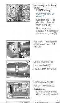

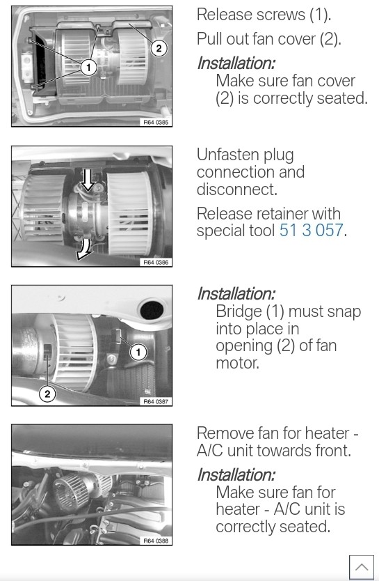

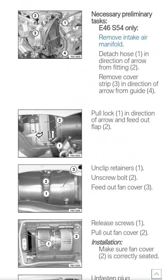

    Man, this brings back bad memories. I removed that rear firewall and the side ones. Take the beauty cover off and never put it back on unless it's for a car show. You're going to be forcing it out along with the blower motor. I did it without removing the intake or wipers, however it was a major struggle. Here are the actual instructions. There is no easy answer. It specifically says take out the intake for the S54.
      Luckily removing the intake isn't the worst thing ever on this car
