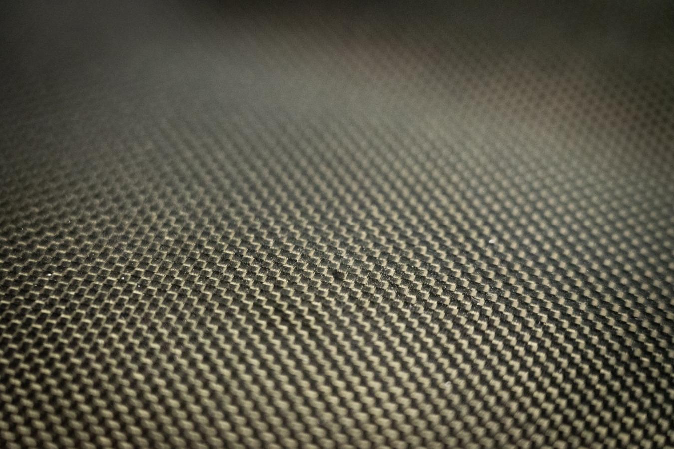

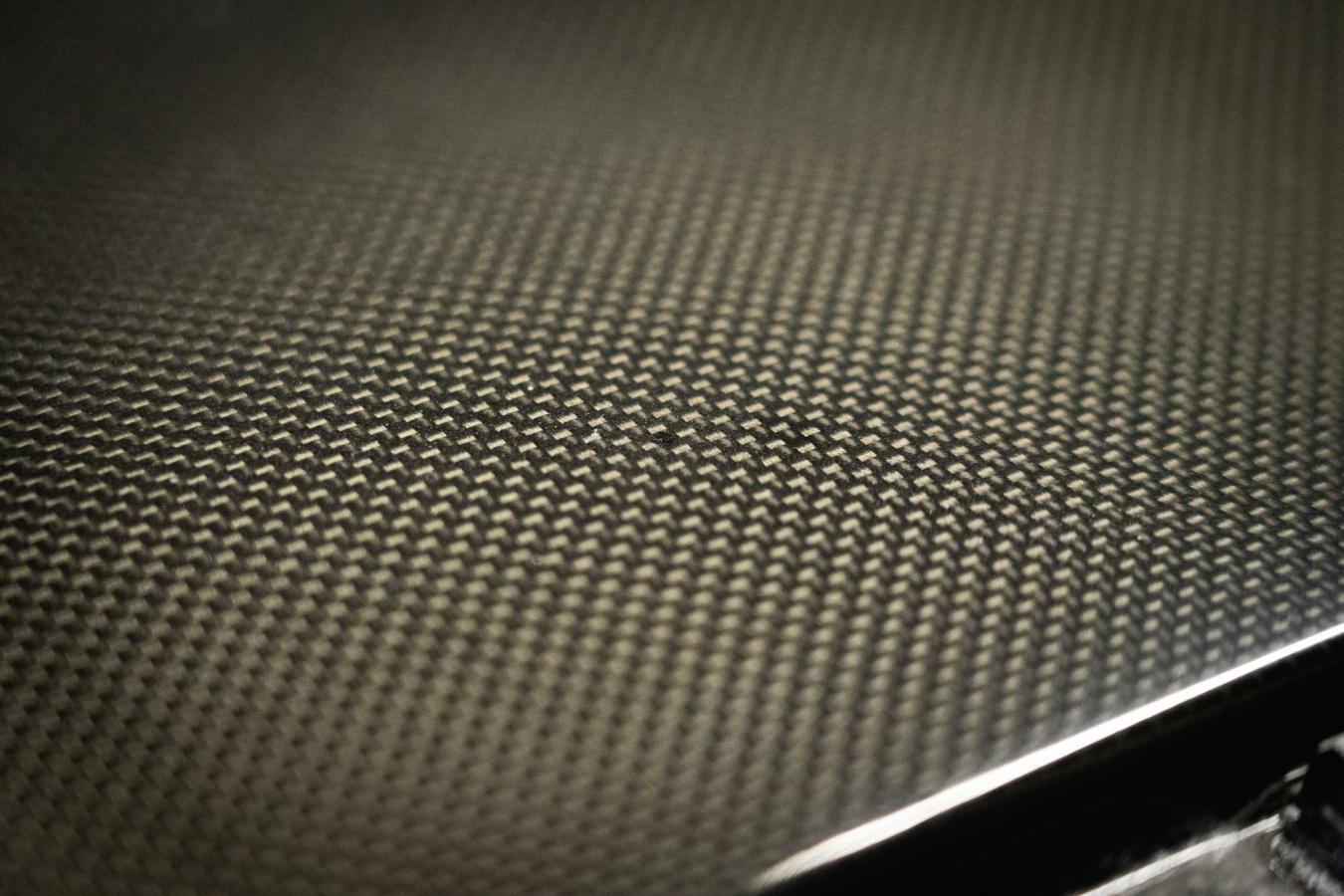

    100% always PPF a carbon roof. The clear coat needs to have cured. These roofs are probably all made to order so consider the timeframe from production to PPF application to avoid solvent evaporations messing up the clear coat, and PPF adherence.
    Repairs can be done on flaking clear - but a rock chipped carbon weave cannot be repaired. On a recent E92 M3 I helped to sell, we corrected the flaking roof using black touch up to hide the chips.
    See below.
