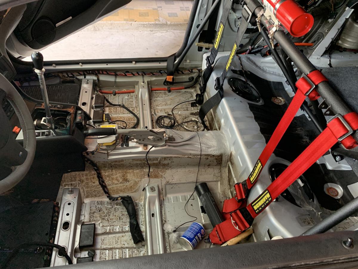

    I’m adding sound deadening back to the floor of my car after I was forced to remove it a few years ago. I looked at Dynamat’s offerings and wasn’t sure which material would be an equal replacement for the OE material. Open to using other brands as well if they’re better. Please help.
    Also, are there any areas that would benefit from the addition of sound deadening?

          Cool, thanks. Will treat the doors. Should I add some behind the rear door cards as well? And why would bmw put sound deadening on the floor if it’s not very beneficial?
              removing your rear door cards (and additionally that extra metal panel behind the airbag) to add deadener and sound absorption material is worth it imo if you have the spare time.
              im not saying adding more sound deadening on the floor will get you no results, it will just be minimal, especially compared to treating your doors first since they are more sound transparent
