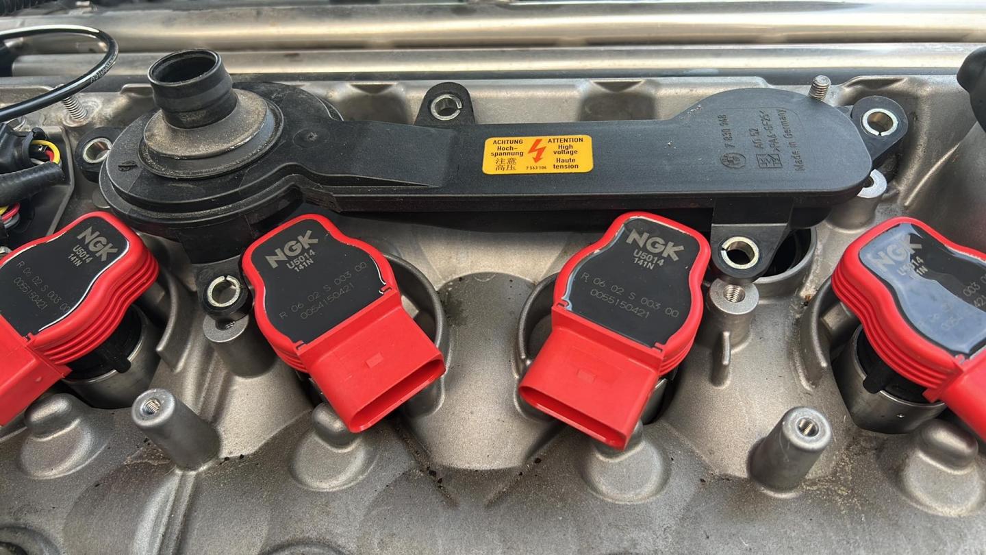

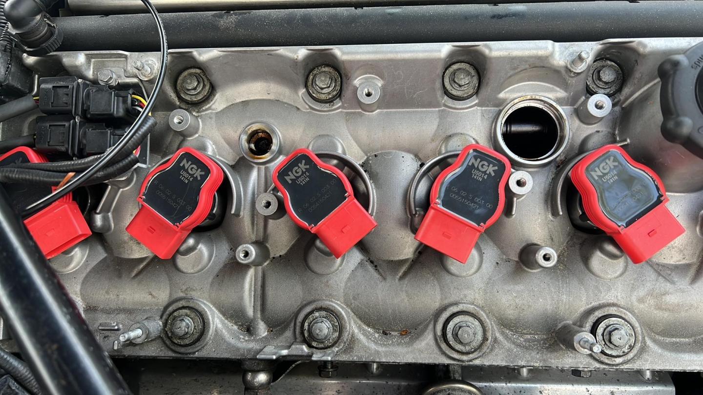

    Anyone run a custom PCV setup on their S54? I've made a plug and play harness for my MaxxECU standalone, and it requires the use of IGBT ignition drivers to run the stock coils, or use of 'smart' coils. I opted for the later, however they foul the PCV setup.

    I'm wondering if anyone has welded bungs or similar into the cam cover and then run a catch can or similar.
    Cheers
