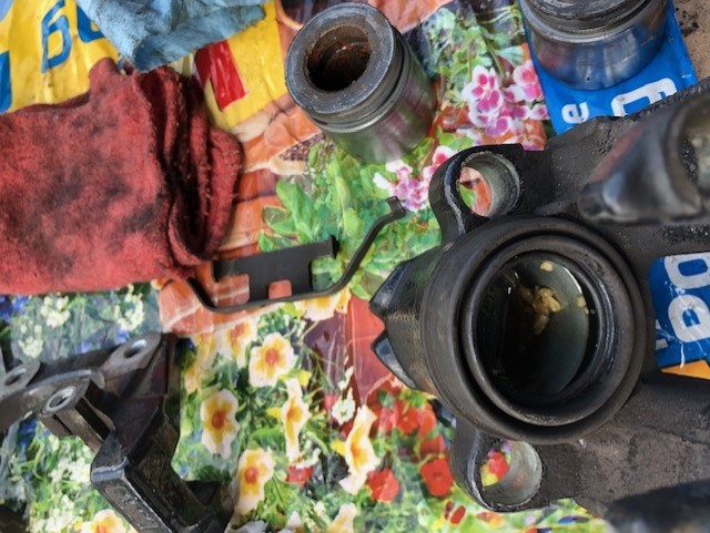

                    Thanks for the input. I did notice that on all four of these calipers, once I popped the pistons out, this solid material was inside the caliper bore--is this a solidified / congealed brake fluid? See attached picture, with white clumps inside the cylinder.
                      I can't get a good sense of it as I've never seen it before. Possibly moisture contamination in the fluid. Watch your bleed-off to ensure it comes out clear. Else keep bleeding.
                      Check the Master Cylinder for junk.
