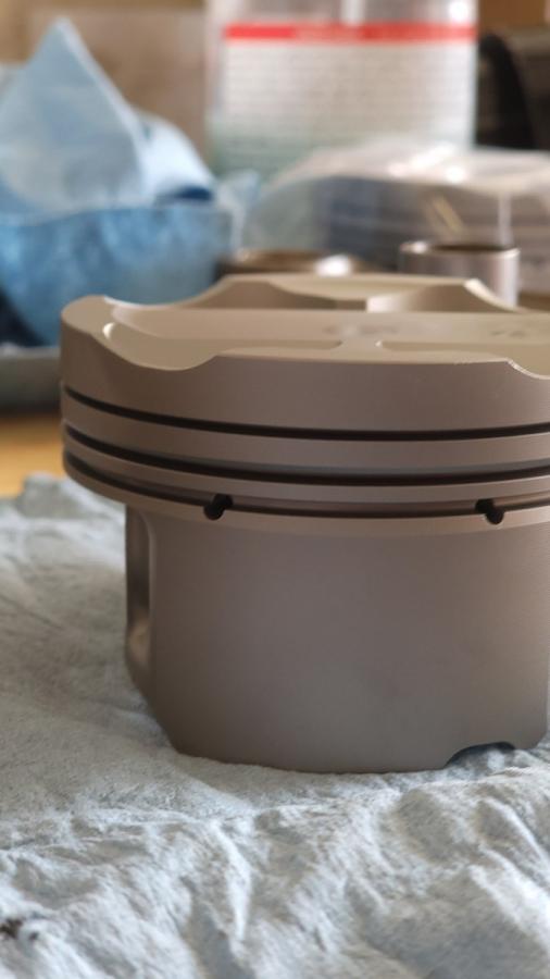

      I agree, it actually is great fun but I think what takes away from it is down time and cost for most people. At 90k miles I probably would not have done it myself just because my 200k mile motor was in such amazing condition when I disassembled it (minus the rod bearing) and still didn't burn any oil. If I caught the rod bearing in time there is zero doubt it would have made it to 300K. Check out these WPC pistons from that motor below, crowns, ring lands were perfect and zero pitting. Before getting them WPC treated, they still had most of the factory graphite coating on the skirts.

        I have done 95% of the whole shooting match, the other 5%, the rings and cylinder walls don't need restoring.
        A dry compression test showed 185 psi on # 1, 2, 4, 5, 6, Vehicle Discussion showed 190 psi. It would be silly to mess with numbers like that and a waste of money.

          who said drive it until it breaks? I also agree that it doesn't need the rings done i just think it is ironic that you say "I like knowing every component is in the best possible condition. I've torn the car down to the last bolt at the moment while I refinish every surface, replace every bushing, bearing, gasket and seal."
          If it was me going that far I'd have been getting some custom Mahle MS slugs with modern rings a small overbore, massage to the CR, perhaps deeper pockets and future proofing it and improving things while i was at it.

            What's ironic? Everything will be in the best possible condition, installing new rings doesn't guarantee you better numbers, I've seen rebuilt engines that had more erratic compression numbers after the work than they had before the rebuild.
            Once the engine heads off to the machine shop I loose all control, I don't have the right equipment or expertise so what I get back from them can only be tested once it is fully assembled and running.
            Then if I'm not happy with their work I either have to put up with it or forget using the car for the rest of the driving season.
            In this situation, having such good compression numbers not only saves me a bundle of money but I remain in control.
            I too would love to have stronger, light weight pistons and an overbore, if you are willing to finance that extra work I would be more than happy to take you up on the offer
            Unfortunately, I'm already at twice my original budget for this refresh and it keeps creeping up every week, when the car is done next spring I'll have all the basics covered with a few frills added. I'll just have to wait for some more money to appear before I start adding the goodies.
