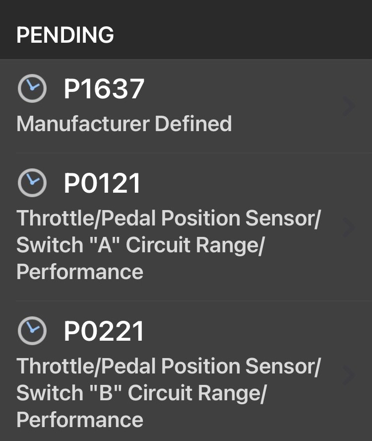

    Had a little hesitation on acceleration in last week and last night got this code and limp mode. I replaced both throttle position sensors with Genuine BMW ~35K ago. Been great.
    Would this be an accelerator pedal potentiometer going bad? I’m away from home and don’t have my books to look up. Thanks

    Do you have access to BMW-specific scan tools?
    I think it's most likely the throttle position sensor(s). For a while I had to replace them annually. Particularly the one by the oil filter

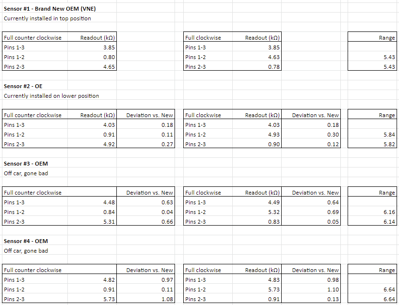

          That's basically saying the two throttle position sensors don't agree. Don't know which one is actually bad. It's not the gas pedal
            See below for reference: the first row are the readings I got from a brand new VNE sensor with BMW logo ground off. You can see how much the values had drifted on the other sensors I had lying around that had gone bad.
            Perhaps this will help in narrowing down which sensor it is. If you're getting hesitation in the middle of the gas pedal range then could also be a dead spot on the sensor where you'd see the readout zero out on a multimeter. In my case I would get limp mode at full throttle, when the deviation between the two sensor readings exceeded the acceptable range.
