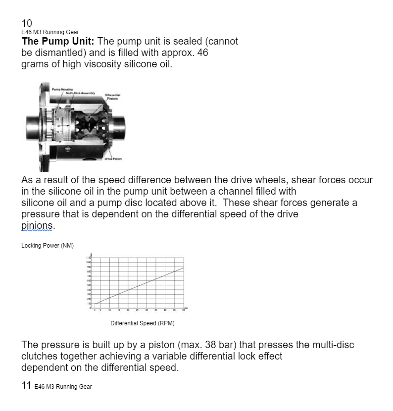

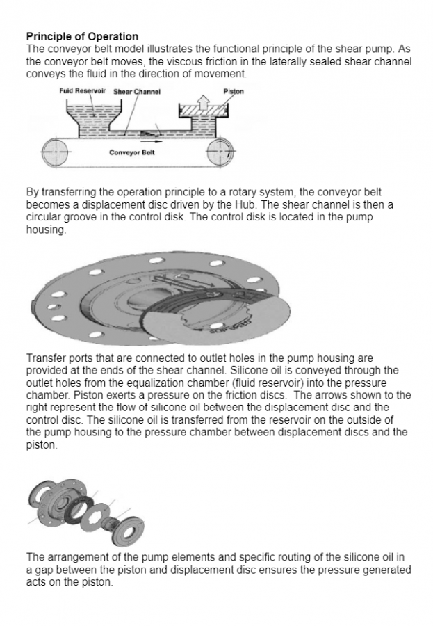

    So throughout the years, many bash on our diff for being a viscous clutch when it is simply not. It doesn't matter how knowledgeable someone is on differentials, wrong information is wrong information. Here is the right information.
    There is actually a piston that can create up to 38 bar on speed difference between wheels. This is not due to fluid warming up causing clearances to tighten which is how VCLD works. It has nothing to do with temperature or fluid in the clutches. There is a shear pump simply activated from wheel spin difference. The system holds about 46 grams of fluid. The chart shows it activating at a 2 rpm difference at a force of 180nm and at 5 it is a little above 200. The line is linear from 2 to 50 difference of rpm.
    I can't transfer the chart but the slope shows about a 90nm increase every 5 rpms.

    Some pictures would help if you're able to share them. The problem is that differentials are named by the nature of their method of transferring energy. If our diffs are transmitting energy through fluid friction only, it still sounds like a VLSD in practice. To me, it sounds like you are saying the "M-Variable" differential means they have used a VLSD and applied a pump to it which drives the amount of lock (via fluid pressure rather than purely through temperature). If that is what you are saying, it is still a viscous differential, even if it is slightly more advanced than the typical unregulated VLSD.
      My '05 came with a technology brochure which had some kind of graph on how the lockup rate of the LSD worked.(It had some interesting engineering chart I haven't seen anywhere else / online) I can't seem to find it anywhere on the internet. (I don't have the car any more otherwise I would post it).
        Click image for larger version  Name:	Capture2.png Views:	41 Size:	140.2 KB ID:	167242 Click image for larger version  Name:	Capture.png Views:	40 Size:	375.5 KB ID:	167243
        It's not public information. It's in the functional description of the E46 M3. There's a whole document on it and this is part of it.
          It'll still have to the characteristics because the clutches are wet and you can't escape physics but the pump is the main mode of operation. It's a cool design in my opinion. Obviously, it was not designed for a track car. Once again, it's that compromise between drivability and performance.
