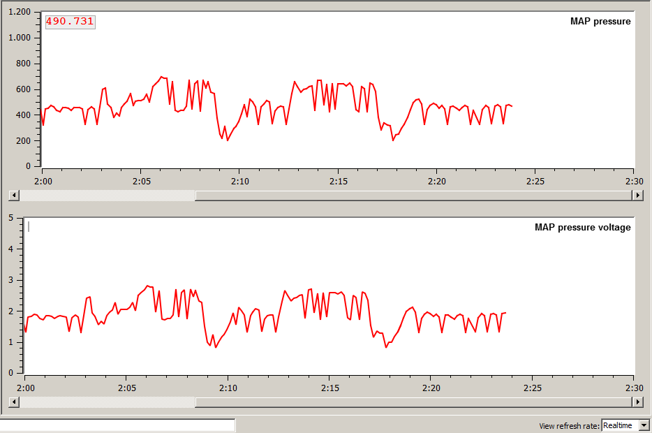

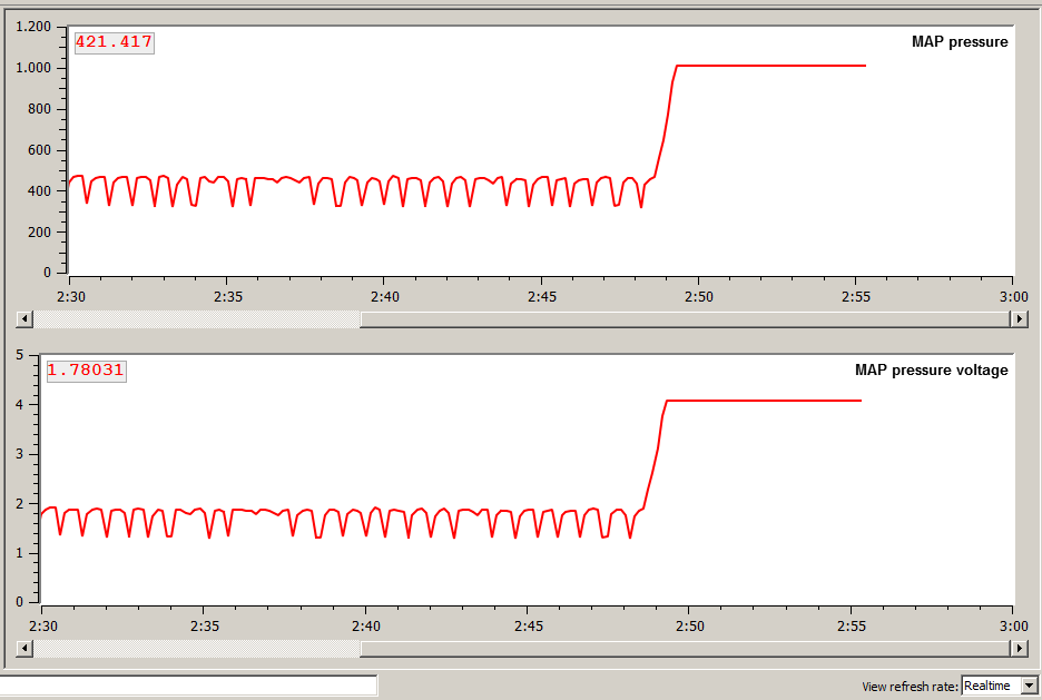

    So....I just installed Testo on the laptop and collected some data from the MAP pressure and MAP voltage. Data was collected on "Realtime" refresh rate.
    Here is what I got. Initial dip in the curve is from startup.

    Here is the data revving up to 3k twice.

    Here is idle again and engine shutdown.

    Data is consistent with what Cubieman collected. What impact do we really think this has on the engine while running?
    terra / Cubieman - what refresh rates did you both collect data on?
