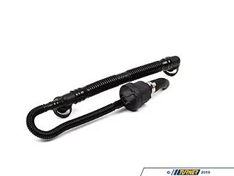

The default state of that valve is open. You'll have a vacuum leak if you don't either get a pre-04 / CSL rail or plug the vacuum port.

If you're going to be running the CSL engine software, then you have to delete it.

That little extra electronic valve was actually only on later model cars (I think sometime 2004 and later?). Earlier M3s just have a hose that's exactly like the CSL's, only shorter. Since earlier M3s don't have that valve I'm pretty sure unplugging it would have no effect in terms of CEL/DTC on a normal factory tune. But even if there was, you should be running CSL software anyway, and that wouldn't know what that valve is, so definitely wouldn't throw a CEL/DTC? So with that in mind, I would think that there's absolutely no point in retrofitting it into your CSL setup, as it won't do anything.Last edited by ATB88; 04-25-2020, 06:49 PM.

CSL breather tube
Doing a CSL box soon, I've got a CSL breather and had planned on modifying it to hook into the little tube/valve on a standard (US Spec.) M3.
After looking at pictures of different people's CSL box installs I've noticed the vast majority do not modify their CSL breather.
What effect does eliminating this extra tube/valve and unplugging the connection to the valve have as far a DTCs/CEL lights go?
Pics for clarity:
US Spec. :
CSL:
