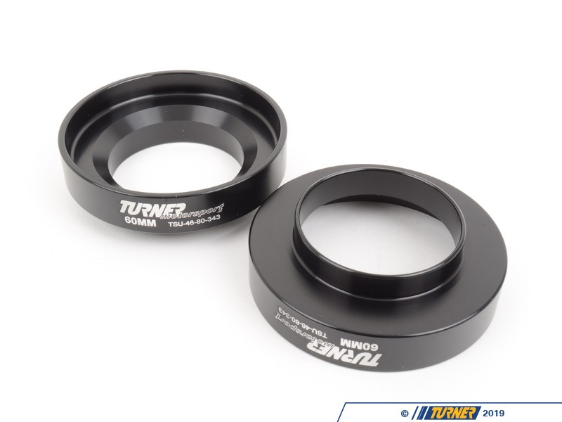

    I'm having a pair of 2.25" spring perch adapters machined to use my Turner street plates with a Bimmerworld MCS system. I would think that you can use this for 60mm springs too, but I'm not 100% sure on that. Would anyone be interested if I had extras made?
    Turner keeps pushing their ETA on their 60mm perches back and it says January 2023 now. I figured this might help some people out if that's leaving them hanging right now.
    Pic attached so everyone knows what I'm talking about.

    60mm springs would be slightly loose on those. They'd probably work but are not perfect.
      It'll definitely work with 60mm springs like 2.5" springs work on 60mm perches. Not ideal, but not problematic either. I suppose, just guide the spring into a central position around the shaft as weight is put down to be safest? Prob still doesn't matter.
      As far as looseness, unloaded, you could wrap the vertical wall of the perch with some tape just to fill the space no problem.
      Once weighted by 800lbs, the spring won't be moving.
